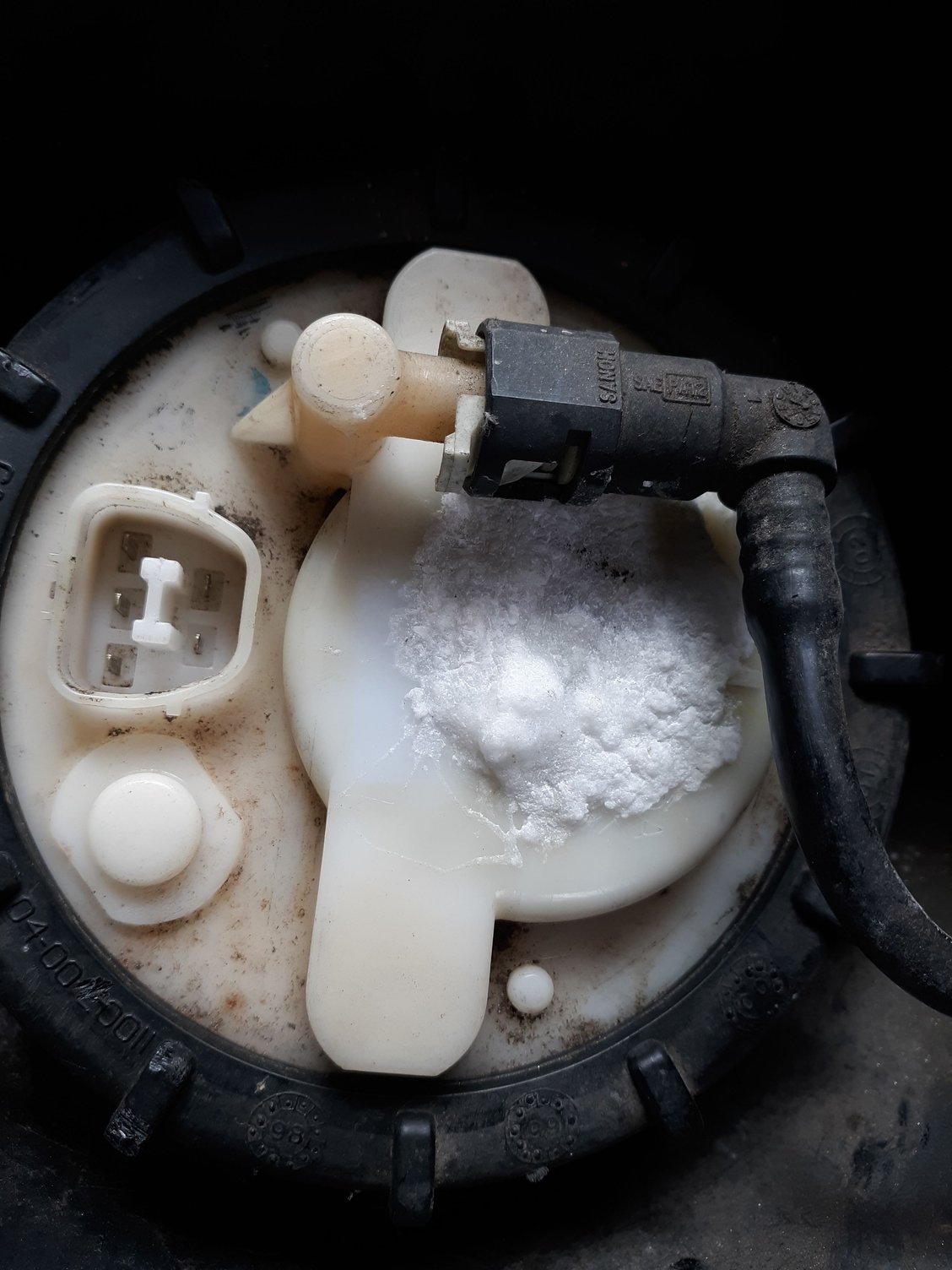

Found it and patch it with crazy glue + baking soda mix I checked 7 Civic 2001 - 2005 in the junk yard. All had cracks.
Stupid cracks
crazy glue + baking soda = solid rock
