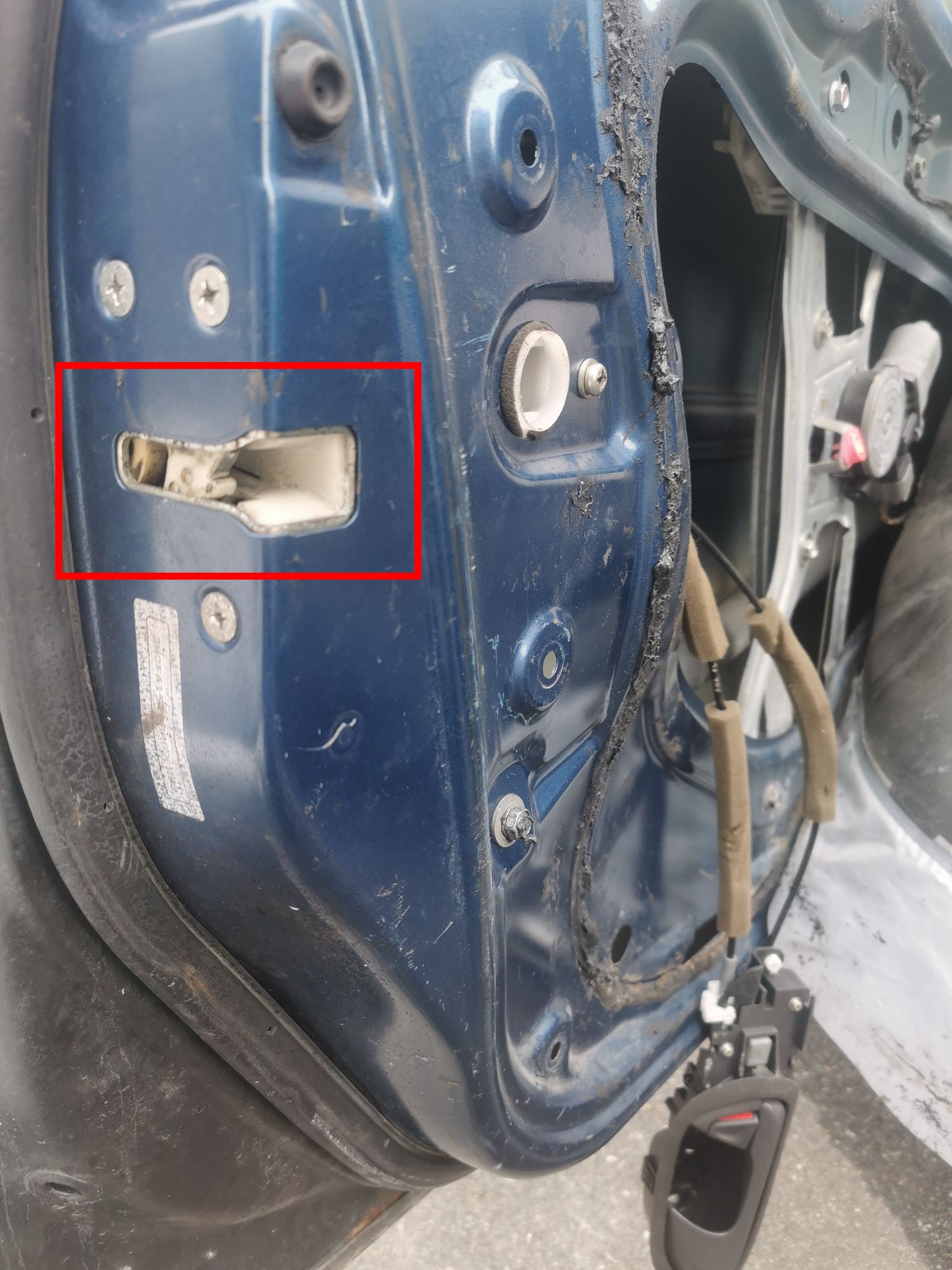

The drivers' side door of my 2008 Honda Civic DX stopped opening a few days ago. All of a sudden, I was unable to open it from the inside or the outside. Of course, when something like that happens, you keep trying to open and close the door. After several attempts, I was able to get out of the car once, but then I shut the door and was unable to open it. So I kept attempting to open the door. Managed to get it open and closed a couple more times before it stopped opening at all. I then partially dismantled the door to get it open, and left it that way so I could work on it. At first I assumed one of the hooks inside the door panel had somehow fallen out and I would just need to open the door panel and put them back in place, but when I opened up the door panel, that's not what I saw. The hooks were fine. Then, I got the great idea of experimenting with the passenger side door, to see if I could figure out why the drivers's side door wasn't working. I used a screwdriver to manipulate the door lock actuator of the passenger side door - and then it got stuck, so I can't open or close that door either now.
Passenger side
Passenger side
Drivers side
Drivers' side
I don't know if these actuators are broken and need to be replaced, or maybe there's something I could do to get them working. Especially with the passenger side, because there was no issue with that until I stupidly manipulated it to see how it worked.

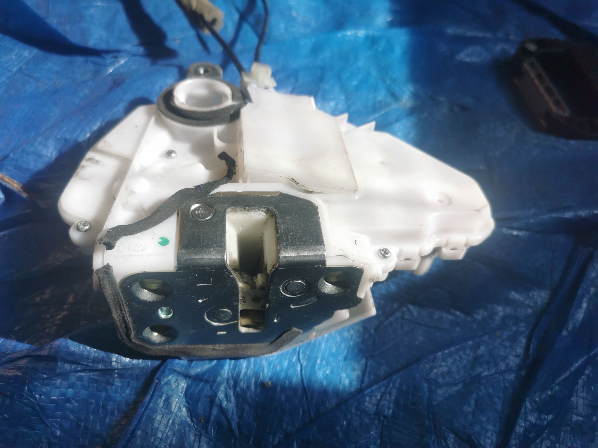

I just removed the drivers' side actuator and was playing around with it to see if it's operational. It seemed to be operational the first few times I manipulated it, but then it stopped responding to me operating the door handle, me operating the metal lever the door handle is connected to, and me attempting to manipulate it directly with a screwdriver. Video:

That would be the latch, not the actuator, unless they became one integral unit on the newer cars.
could try lubing the hell out of it but i would just grab another latch.

The latch is part of the actuator - that's why I'm asking about the actuator. This is what the unit looks like:
72150-SNA-A03
72150-SNA-A03

Grab a latch, could gamble with the junkyard, or go new from the dealer or maybe aftermarket from rockauto.
