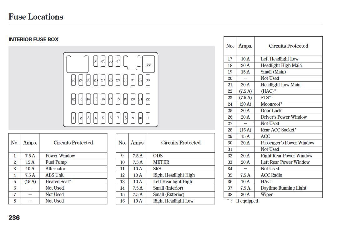

Anyone have a clue where the automatic light fuse is in Civic 2006?

They told me in the service that it could be automatic light fuse. I can't find the fuse from the manual. Anyone can hint me which one could it be?
Old Jun 16, 2023
Posts: 15,190
Likes: 1,609
Re: Rear lights turning off problem
37... that is the official name, DRL.
Old Jun 19, 2023
Civic-06's Avatar
Joined: May 2023
Posts: 14
Civic-06 is an unknown quantity at this point
THANK YOU! Will check it out when I'm at the car next time, but I think this is it!
