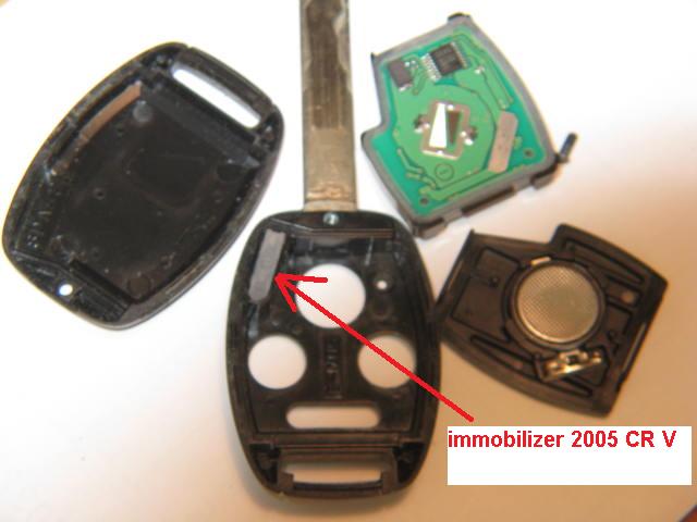

Did a little checking but still do not have Civic..The first attachment is the 05 CRV with the immobilizer on the key body. Just that part will start key all apart.
Second picture is how the 07 Civic with no part like that on key body looks. No pocket or extra wall.

Starting with 06 Civic the RFID chip is inside the transmitter on the circuit board.
So..
You can buy a blank shell with the key shaft and get that cut to fit your car.
Transfer your original transmitter into the new shell.
The transmitter contains the RFID chip and is already programmed to the car.
It will work this way.
Test it out(?):
Break off the metal key shaft and stick it in the ignition.
Try to start. It won't.
Turn off.
Hold the transmitter up with the key shaft and try to start.
It should start if you get the transmitter positioned correctly so the RFID chip is close enough to the receiver ring.

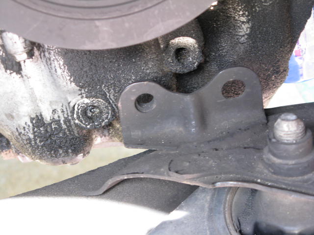

While I have your attention, I replaced drive belt at 108K since it's hard to inspect. It actually looked perfect..totally amazing. However, I noticed this bracket with two holes and two tapped holes in block. It does not appear parallel to block but it is. The holes are just offset from the bracket. Is that to support engine with some type of spacer to remove motor mounts?
The bracket is just there, it's not used by us (me) for anything (I really have no idea why it's there unless for something equipped elsewhere in the world)......
and you ought to fix that oil leak, it looks ugly.
Front crank seal, or tensioner cover?

Appreciate all the help ezone, I did not pay much attention to that mess. It was pretty dry baked on. It's not wet under car or any drips and the crank is not leaking since I looked up under there. Probably from sloppy maintenance.

I think the picture I posted above in 9 on the bracket is to bolt the special Little Girl Japan crank locking tool and lock the engine to prevent motor mount damage for removing and torquing the damper pulley bolt.
