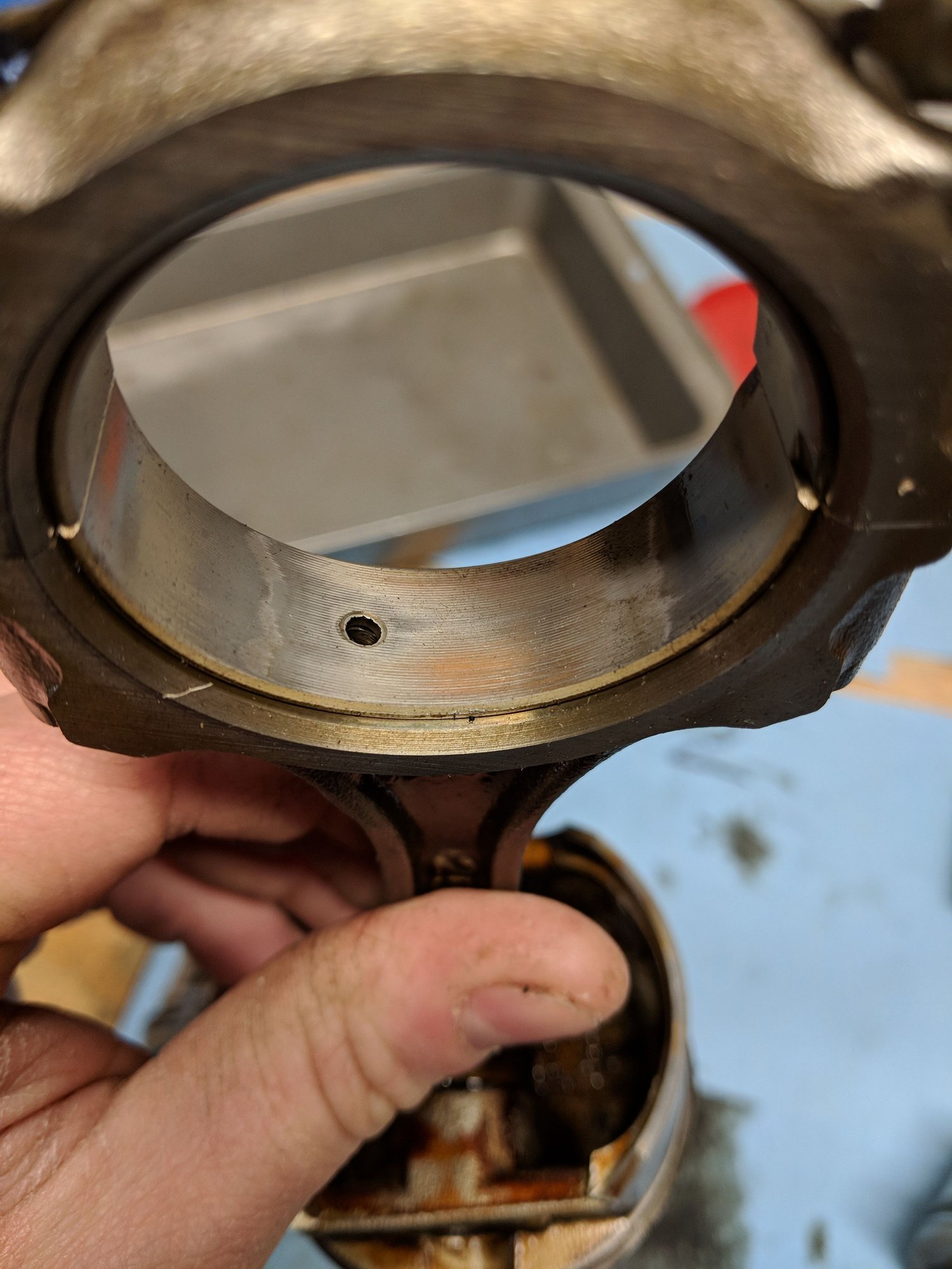

pulled the motor for rebuild and im looking for the correct color connecting rod bearings, honda lists many different colors not sure if mine is red or orange? how would i know what correct rod bearing to select?

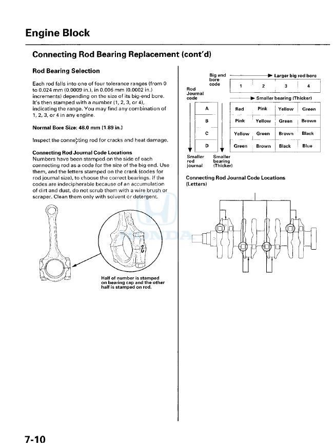

Re: 2004 d17a2 connecting rod bearings - what color?
looks like one should rtfm.....lol
found it on pg 7-10
i have a possibly dumb question... did you look at the back side of the bearing shell? every bearing i've ever seen has numbers printed on the back.
Those actually look fine, why replacing them?
i see brass? and / or wear so i got a new set, crank looked good.
oil rings were clogged as usual , soaking in carb cleaner now.
The important thins are the micro grooves which as still visible, lack of gouges, and no color change.
One few times I actually worry about putting clean gloves on, you don’t want anything between the bearing and the rod.
Also highly suggest leaving the spark plugs out, pulling the ECU fuse and cranking over in 30 sec bursts till your pressure light goes off and then one more burst for insurance.
