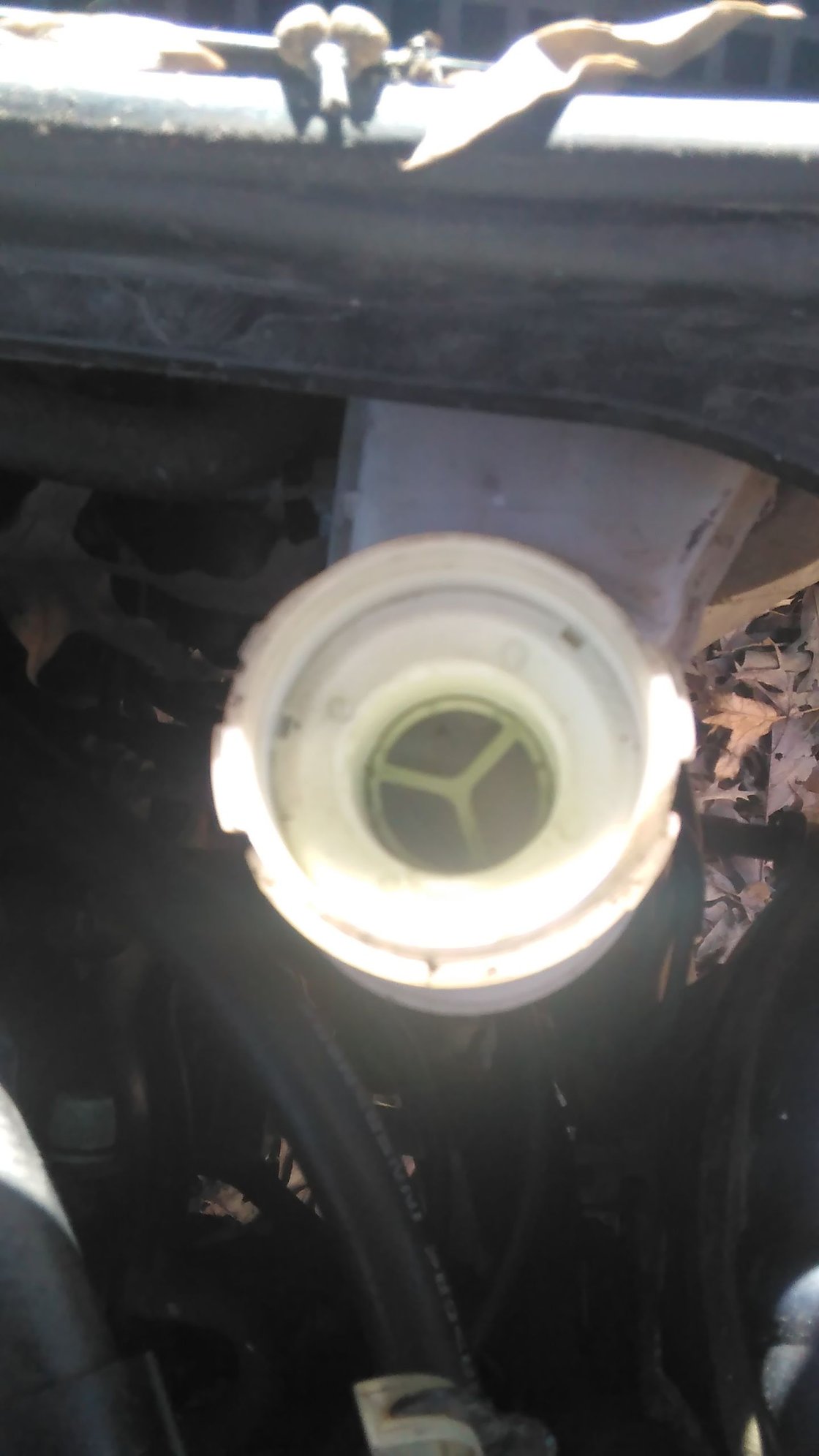

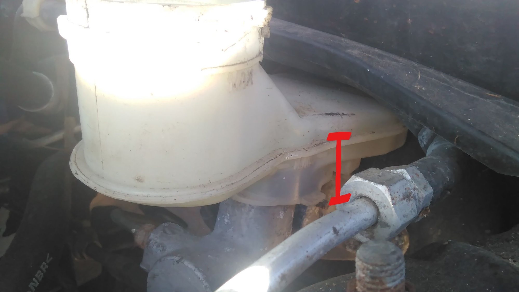

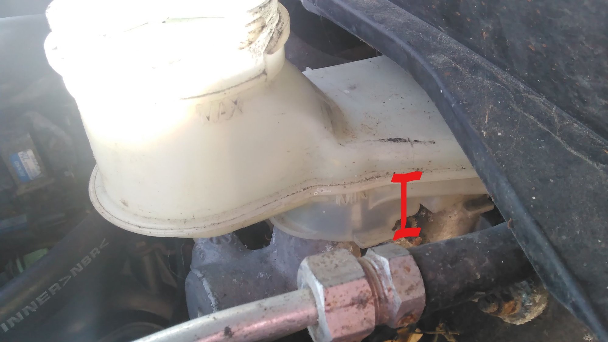

I spoke too soon. There appears to be brake fluid still in there but it is low, at the minimum. I highlighted the area that has black fluid in it with red ink. Hopefully it comes out right.

No, I didn't drive it without pads, I wrote that sentence in an odd ordering. I took out the pads after the pedal was being pushed to the floor without affect on the braking.
Why do the calipers need replacing?
The brake fluid isn't entirely out, I spoke too soon. I posted pictures previously on where it is currently at. It has black fluid up until the "min" mark. When I took out the calipers and placed the c-clamp on there to compress it, the caliper piston was out about a half-inch, does that sound irregular?
