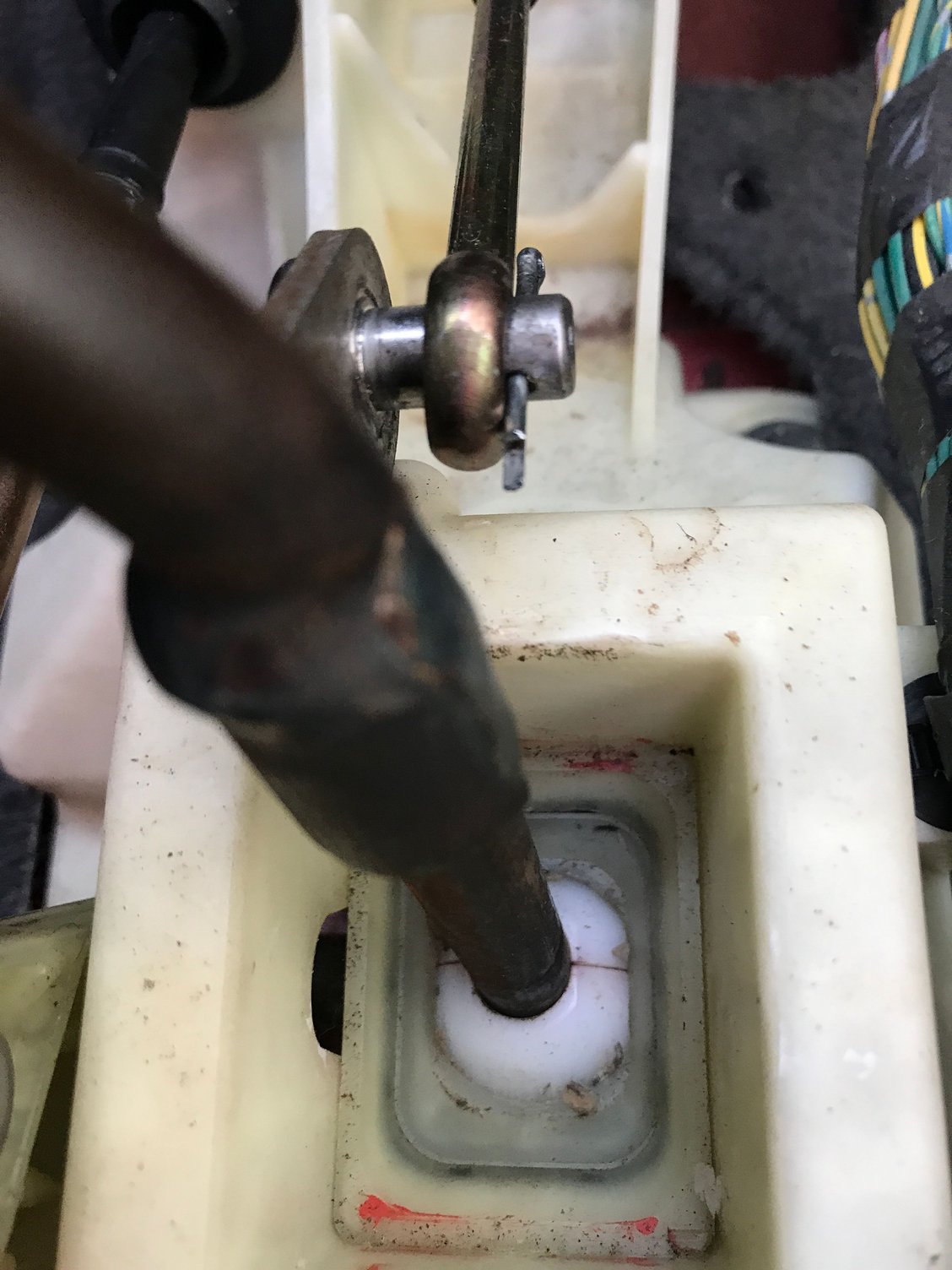

Re: 2001 Honda Civic EX Transmission Dilemma!!!
Those early cars could have that issue with the shifter where the pivot ball splits open causing the shift lever to bind....I wonder if that could be happening here.
Which ball are you referring too?
It's clearly split in half lol
I've found multiple assembly's that are short throws and when you see down where the ball is, it is packed with a good bit of grease. When I push to 5th or reverse the ball splits, so guess mise well start with that first
That's a parting line...unless it opens up when you shove it into a gear.....
If it opens up, it's junk. Replace it.
Yes it opens up when you go to push it into 5th gear or down to reverse.. Now when i get the new one, should I pack it with grease or anything? Tearing that shift assembly out tonight
Brand new unit from Honda would be already lubed when you get it (you will probably be able to see it).
Open box and install.
