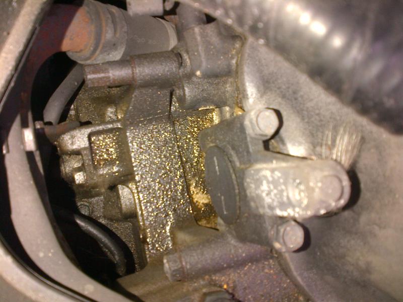

I have a small oil leak, it looks like it gotten worse with the cold weather. I am not sure where it is coming from exactly as it is very small leak but I wiped the area where that round black plug is, I took it for a ride and the leak started to originate from there it seems:
How do I fix that? any advise on what exactly is leaking?
thanks.
man this car is more trouble then I need, I guess thats what happens when you buy a car for 2k.
BTW: it a civic 2002 lx coupe, 1.7 L .

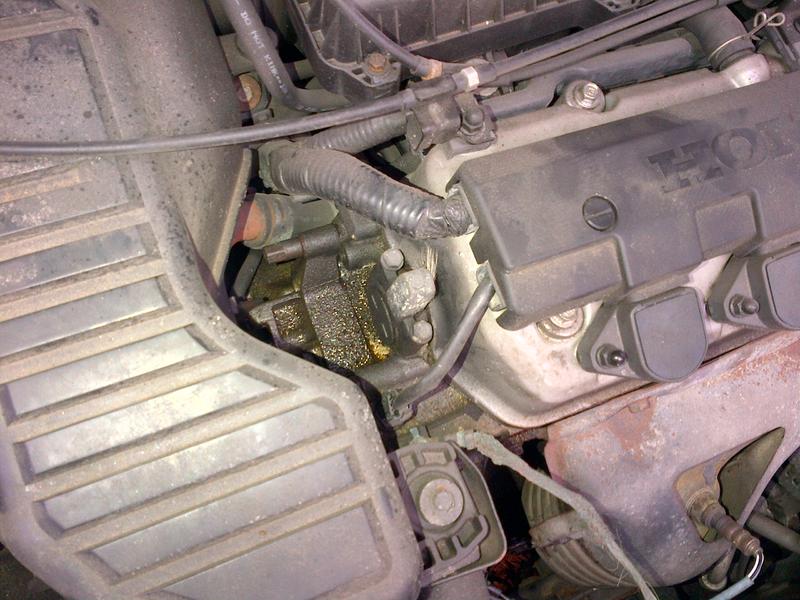

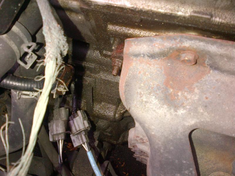

thanks.
EDIT: sorry for doble post, somehow the edit did not work as intended.

looks like it is leaking from a Camshaft Plug. just ordered it from rockauto. looks like an easy fix.
will keep this post updated on the results.

It looked about the same as yours with an extreme close up (LOL), and yours doesn't have an EGR valve in the way where the other poster did have EGR in the way.

lol maybe, I replaced that cam plug and wiped all the oil surrounding the engine....will see if there is more leaks.

I'm very happy with the results, its nice dry inside . in the summer I will replace valve cover gasket, no way in hell i'm doing this job in these freezing temps.
