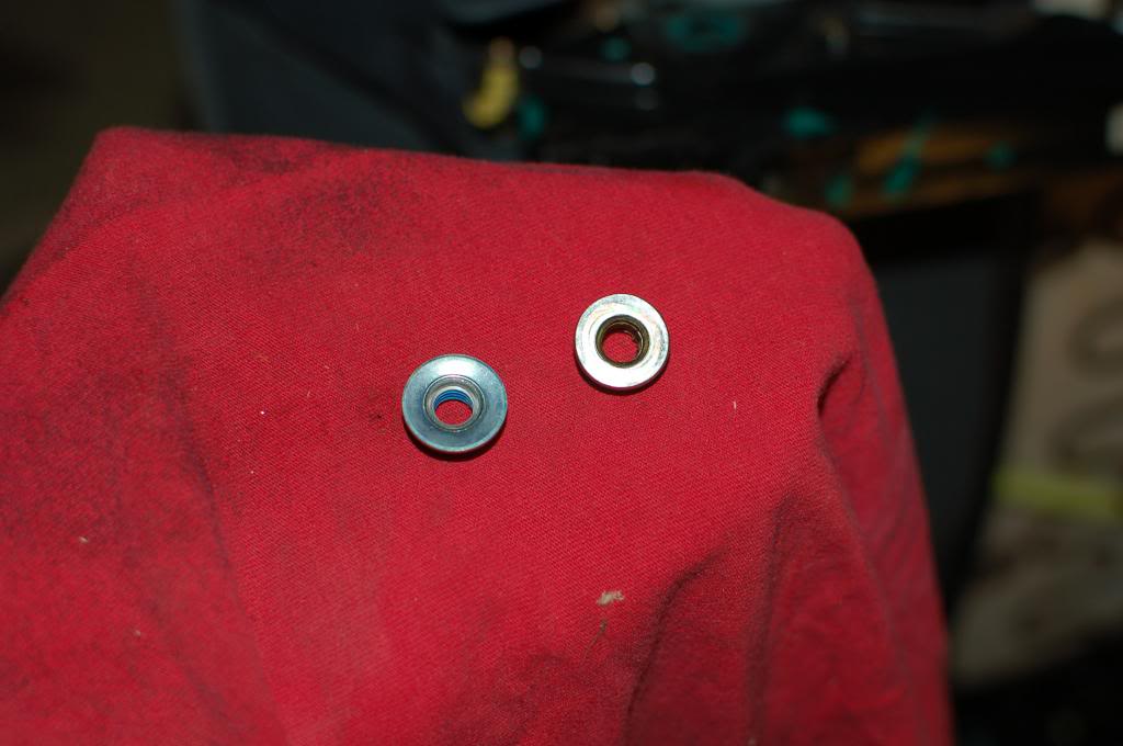

Here is the old vs new bushings. You can see that the old ones, which were on the rear part of the seat, were worn right through. The old front bushings were not as bad.
