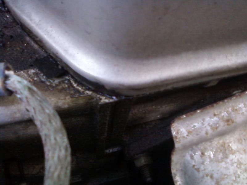

I'm about to put a dc sports ceramic header on my em2, i noticed i have oil accumulation between the block and the head, im not having any over heating issues, what is/ how do i fix this, im sure its simple, thanks in advanced

Valve cover gasket and cam seal are probably bad. Easy DIY.

a picture would probably help

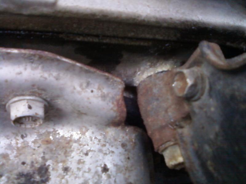

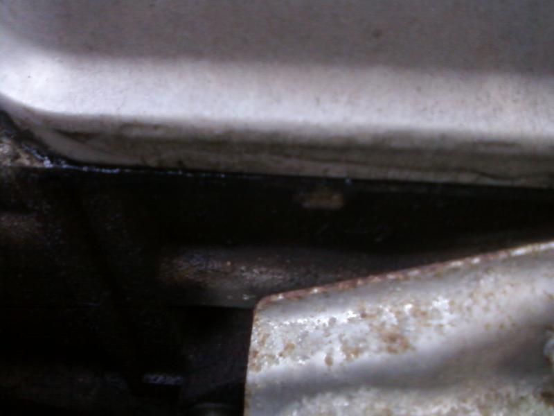

ask and you shall receive how about 3,, sorry my camera sucks

hard to tell but looks like valve cover gasket,
while you are doing your timing belt and have the valve cover off, i would suggest replacing the valve cover gasket, the camshaft end cap/seal (passenger end of cam), and the 4 seals around the spark plug holes, that should take care of all possibilities,

there is a cap that seals the passenger end of the camshaft, where the distributor would be if the car had one....its fairly common for that cap to develop a leak over long periods of time and, when it does oil will drip down and sit on top of the tranny, there are many threads on here about it,
