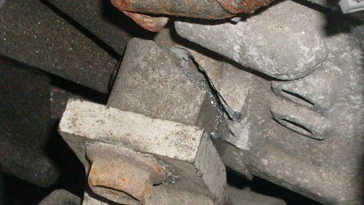

Hello...I have a 2002 Civic coupe with an automatic trans,just over 61k miles.Last week it started to make a whining/squealing sound, I thought it was the alternator going bad---wrong! My son had it out and said it was shifting bad, I checked the fluid, it was a little low but in the safe zone. I went for a drive and when it shifted from 2nd to 3rd it slipped a lot.Topped off the fluid and the whining got not as loud. -Next day took a while to engage when coming out of park,forward or reverse and slipped through the gears--Today no motion in any gear. Before I bought it it was involved in a front end crash and the front motor mount is no longer bolted to the motor it is welded. Is that piece between the motor and trans like a bellhousing or is it the torque converter case? The end question here - when the trans gets rebuilt will that need to be replaced? Here is a pic before it was welded looking down from the drivers side,I don't have any of it welded. Thanks!

Umm yeah. I'd probably be using some coin to buy a reman trans. I personally would never trust a weld on something like that.
That's broke next to where the block and trans housing meet.

I have been driving it for 6 months with it welded.I found a trans from a 2000 Civic on craigslist will that bolt up to a 2002?

My "cheapazz" idea is working, the weld didn't fail...the trans did=different issue.The part numbers are the same for that case on a 2002 and 2000. Doesn't matter anyway..that one was sold. With the history of these transmissions I wouldn't throw one from a junkyard in with out having it freshened at least a little bit. I'll call around locally tomorrow.

A proper tig weld will work.
You need to find someone who does it for a living.

Its rollin again...turns out,as expected the welding was ok, but the case was cracked on the inside and some internal parts had failed/ broken. Needed to get a new case....OUCH!! But it's rebuilt and shifting like a new car-as it should with all that $$ put out.
