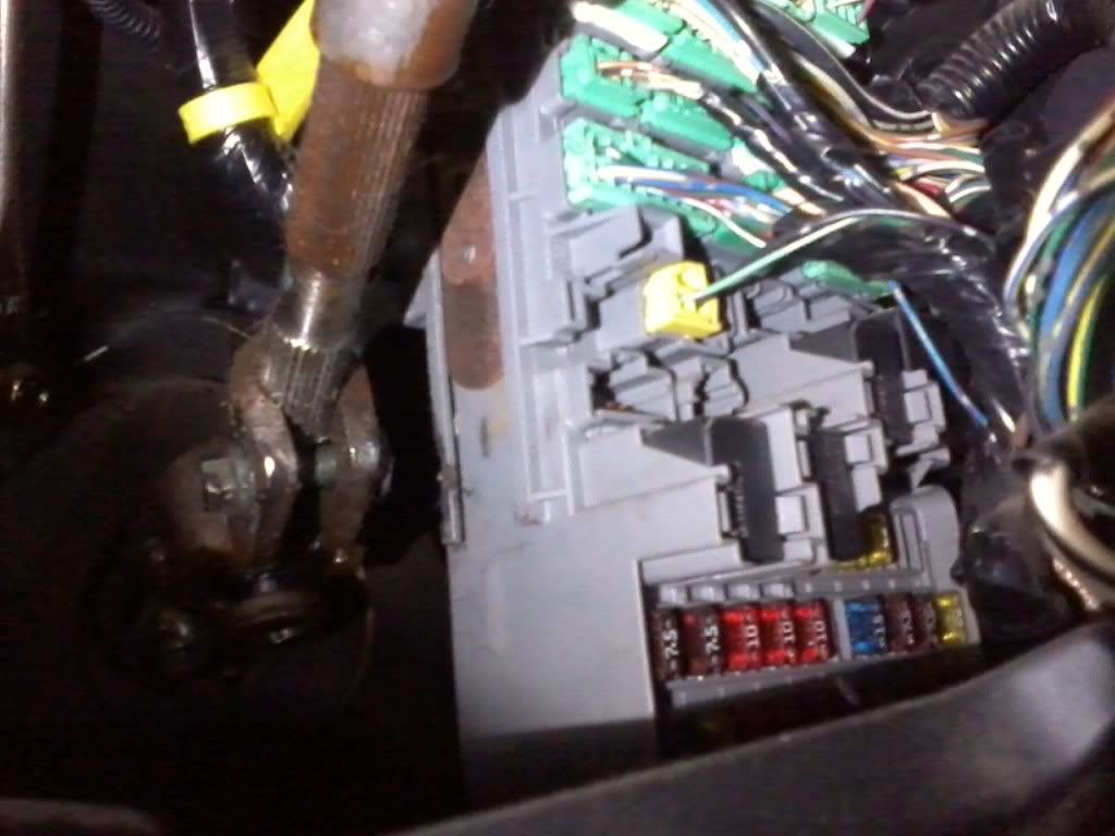

At this point the only thing you can do that doesn't cost an arm and a leg is try to reset the SRS system:
1. With the ignition OFF, jump the MES 2P connector with a wire. **DO NOT USE A PAPERCLIP, it will ruin the connector**
It's in the front of the under-dash fusebox. The MES connector is the yellow one:
2. Turn the ignition to ON(II)
3. The SRS indicator will come on for 6 seonds and then go off. Remove the wire within 4 seconds of the indicator goes off.
4. The SRS indicator will come on again. Reconnect the wire to the MES connector within 4 seconds.
5. The SRS indicator will blink twice to indicate the memory is erased.
6. Turn the ignition to OFF and wait 10 seconds.
7. Turn the ignition to ON(II). If the SRS indicator comes on for 6 seconds and goes off the system is ok.
Some notes: Repeat the procedure a couple of times if it doesn't clear the code the first time, just in case you didn't do it right. Also check for loose/bad connections- AFTER you disconnect the battery negative terminal and wait AT LEAST 3 minutes (don't want to blow the airbags).
