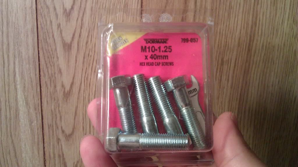

Re: Cat Change corrosion issues
I used this Name:  IMAG0192.jpg

Rep Power: 513
As long as they're long enough to penetrate through the 2 flanges and the nut, you'll be fine. That, and the diameter seems fitting for the exhaust.
M10x1.25 sounds like what I used also.
