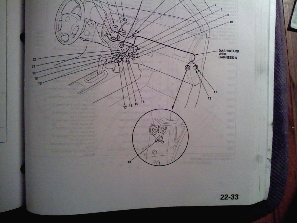

Do you have a multimeter (DMM)? Can't properly diagnose without one. In the meantime, check for blown fuse 14 in the under-dash fuse/relay box and loose connections at the control panel and ground G502-
#13:
Service manual says it can only be a loose connection, the control panel, or the motor. Get a DMM and you can diagnose instead of spending money just replacing things.
