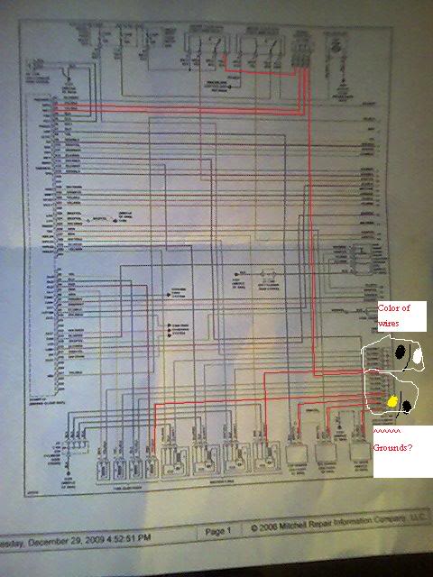

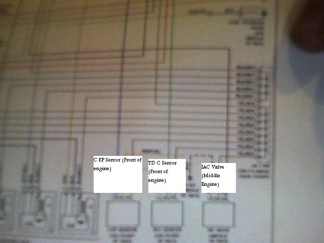

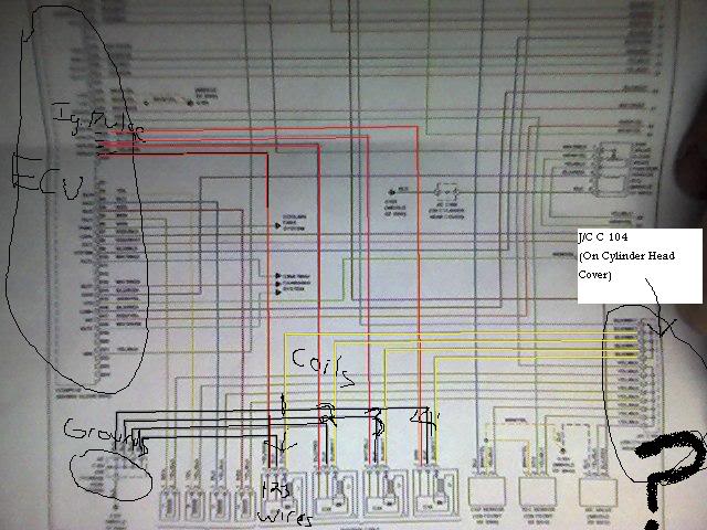

I have a 2002 civic. D17A2 Ok so i checked the continuity of the grounds on the coil pack plugs. they are all grounded.. they work fine. i turned ignition on and had 12v between the middle hole in the plug(ground) and the left Hole in the plug(Wire going to J/C C 102).the third one i tested to ground and had no continuity. tested to Power (Wire going to ECU) and got 6v. hmmm?gonna get a test light and see if i dont get a pulse when i crank it. i dont think i will. but then what? Crank Pos sensor? gonna check that too. im pretty sure its hooked up. it cranks and im getting fuel. and brand new plugs. all fuses are fine. maybe a relay bad? main relay 1&2 are fine. Anyhting else im missing?
Heres a couple pictures of the diagram hope this helps you Help me lol....
