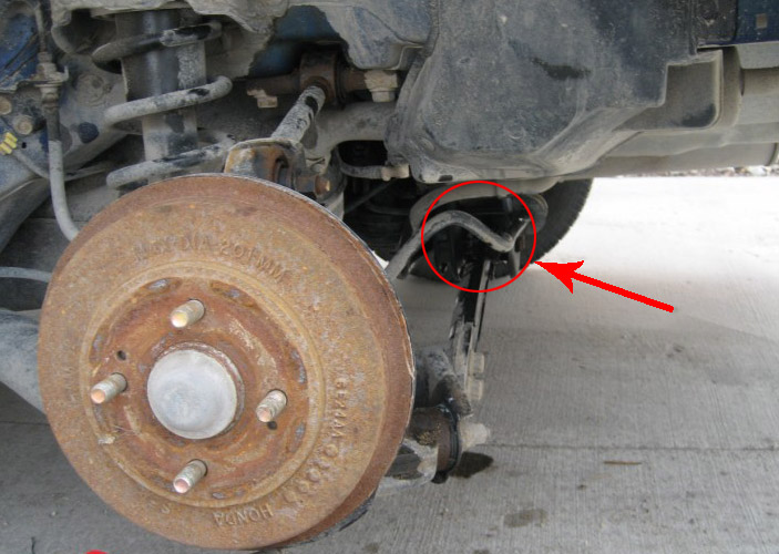

By the way, I removed the wheel and played around. I'm 90% the creaking is coming from here...
Anyone know the name for this piece?
Thanks!

that's the rear sway bar gearbox refered to. blast some penetrating oil WD40, PB blaster, etc. if squeak stops, good. next time it starts, take it out and grease it. search for greases using search function - should be a lot of products, find one that othes recommend and have not a bad review and use it.
Wait... you have 2 things there, the rear sway and the rear arm pivot point. Anywa, throw some oil there and see if they improve. you could do one at a time so you know which one is it, but i guess you are pointing the rear arm pivot. Go easy, BTW if you try to take the bolt out - it is welded on the back side, and the weld sometimes break. took me a vise grip to take it out when installing my progress rear sway...
