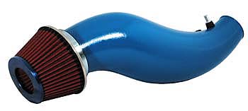

here is a pic

Originally posted by cdmx
here is a pic
that thing is HUGE!!! lol

lol that's huge dude ...
