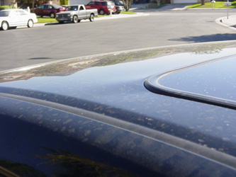

As promised: pictures!

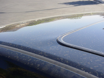

And one more.

Wow thanks for the pics.. now I completely understand what your referring to. So you have you have that on both sides I assume.. I'm going to have to keep a close eye on mine now. Thanks again, appreciate it.

Yeah, I have those dimples in all four corners, although that one's the worst. The ones in the front corners aren't as bad as the ones in the rear.
Yeah, I'm definitely going with the Neuspeed strut tower bar.
