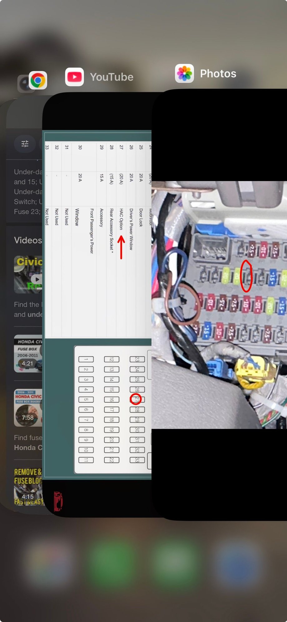

He said when he bought the car 8 years ago, the car had a parasitic draw, which caused the battery to die, so he pulled a fuse, which he said "Without that fuse, a lot of things don't work including the radio, using the buttons on my car key to unlock/lock the door, and probably some other things." I have a suspicion that the fuse was #27 in the cabin fuse box (the HAC or something?), because that fuse is still gone.

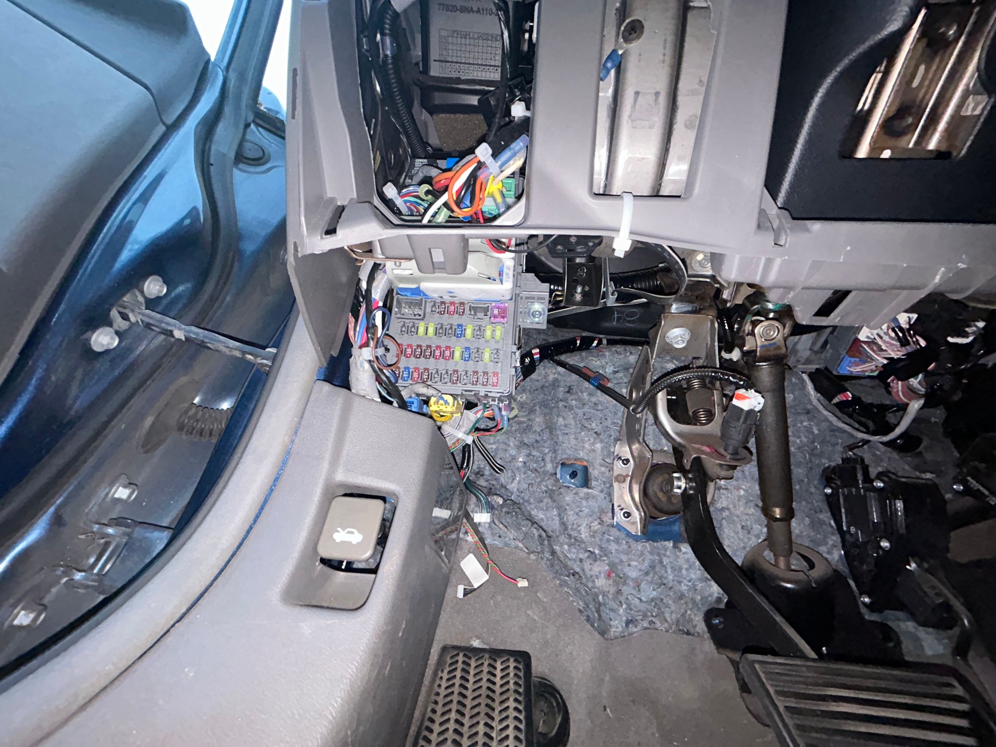

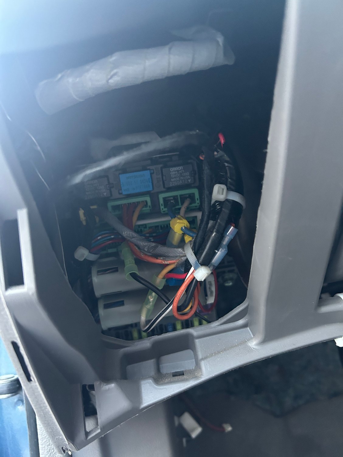

He suspected the car had an aftermarket alarm installed, and when I went to briefly check the car out in person, I saw a bunch of non-stock wiring in the cabin fuse box relay unit assembly. He's been removing fuse #12 in the engine bay fuse box to stop the horn when the alarm goes off, but he's unable to drive the car with that fuse removed (it starts but won't go into drive).

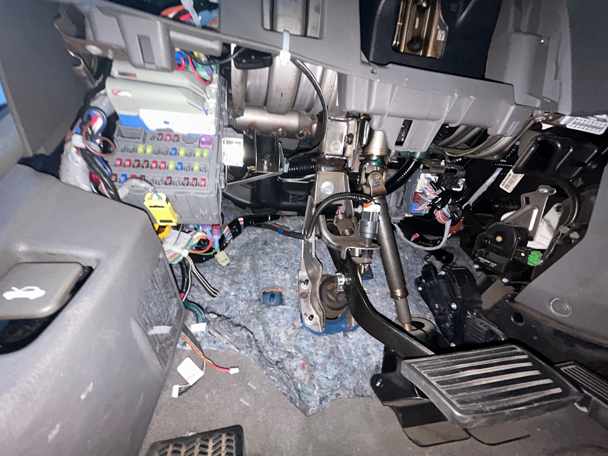

When I checked out the car, I was only able to get some quick photos of under the dash, and I saw that the wires going into the connectors directly under the top 3 relays were messed with and spliced into. I also saw some unplugged wires lying on the ground, which had labels on them (I didn't get a chance to look closer), which looked like they might possibly be part of an aftermarket kit, but again, I'm not too familiar with this stuff.
I attached the photos I took of under the dash. If anyone can make sense of this, I'd greatly appreciate it.
Is this normal on a stock car? Or could it possibly be part of a security system

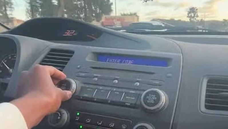

Is this normal on a stock car? Or could it possibly be part of a security system. The "Enter code" message on the center screen.
This was the fuse I think might be the one he pulled out when he first got the car.

Stock honda radios need a code entered for them to work after they've been disconnected, lost power, etc. Should be written in the owners manual, or in something in the glovebox.
but your plan on making the wiring stock is a good place to start, double check before you cut anything
