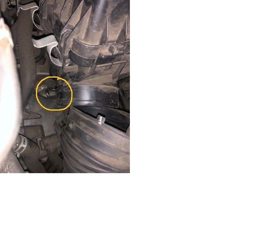

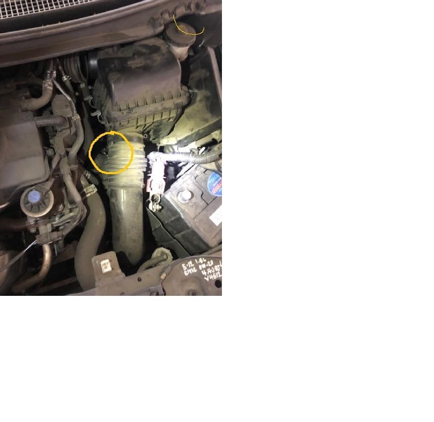

This wire is under the air filter housing.
I traced this positive battery terminal to this wire that is frayed and a small portion of the wire is exposed. Might this be the cause of the problem I am having with my car??

Any body know what this wire is called. It looks like it has those slide in snap type of connectors.

very small, not likely cause, just check if properly connected and use electrical tape to isolate frayed wires from metallic parts of car.
have you checked battery/charging system?
If you are not familiar, car part stores can check it for you
