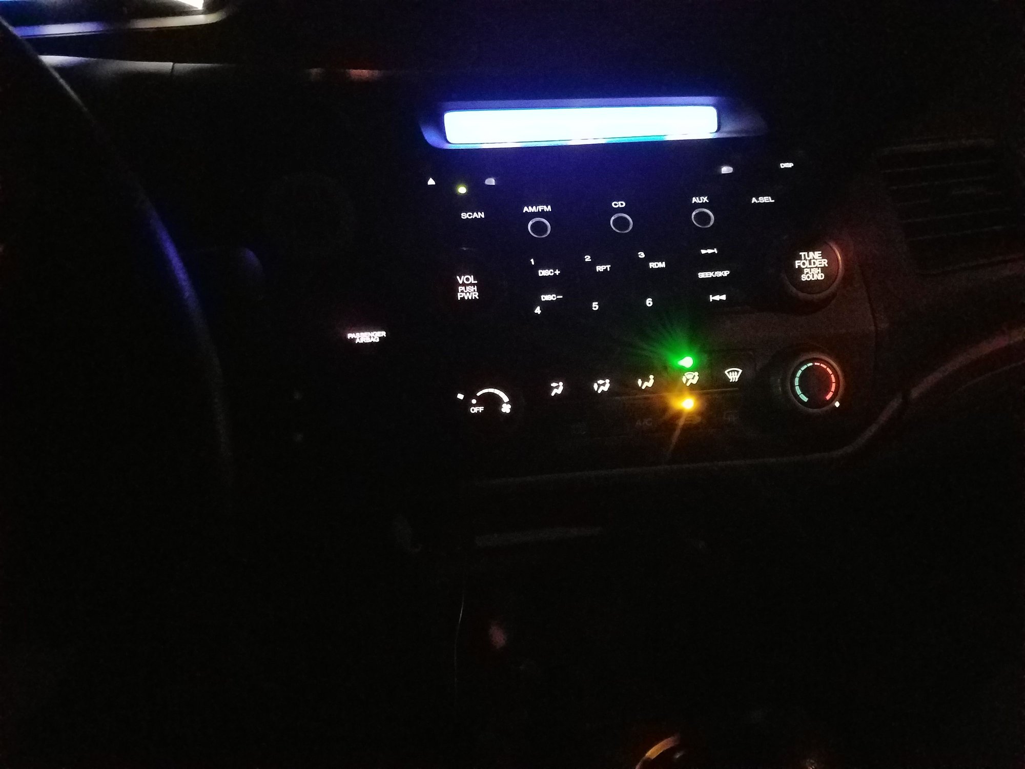

The rear defrost row of buttons don't light up. is this fixable?

Yup, but is it worth your time, is the question?
I would guess that it is not a fuse problem because the other lights around it are working, anad I'd guess Honda would wire all of the cluster lights to one fuse.
Most likely a wiring issue or bad LEDs.
You'll have to pull the dash and investigate.

8th gen--Light bulbs ---- replaceable

so they are replaceable. is that a dealer only part?

You should grab them from Honda..... General crossovers will likely say #74s will work, but they are too large. Likely # 2825 is what is used.
What year Civic ??

2009 4door

Maybe not, but the dealer parts catalog makes it really freekin simple to get the correct parts on the first try. (hint--replace the entire set of bulbs for the hvac panel at the same time)

https://www.hondapartsnow.com/genuin...5-sna-a01.html
Those bulb (filaments) ARE fragile.
