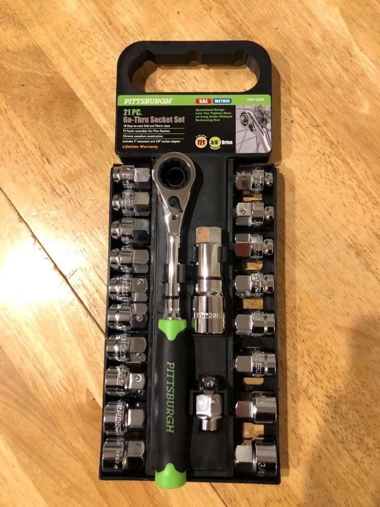

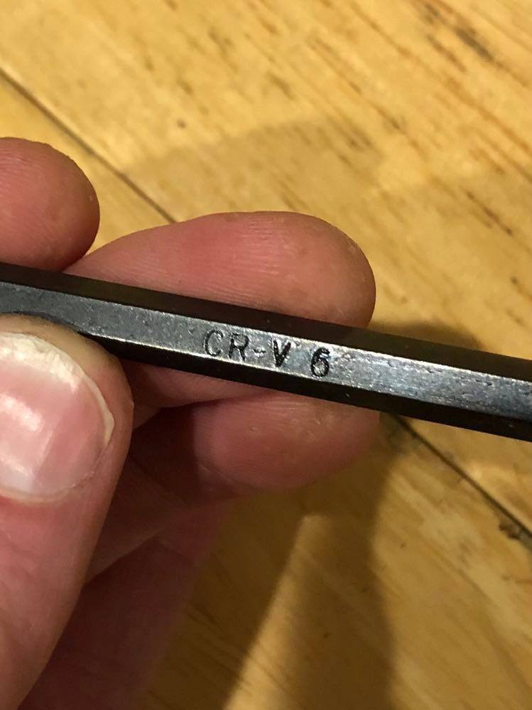

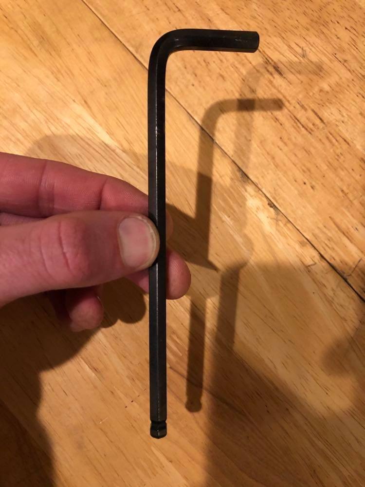

So I removed the driver's side windshield wiper, then removed the side plastic cowl cover piece, then I tightened the top center bolt as much as I could. So far so good! The rattle/squeak is gone!
Here are some of the tools I used:
