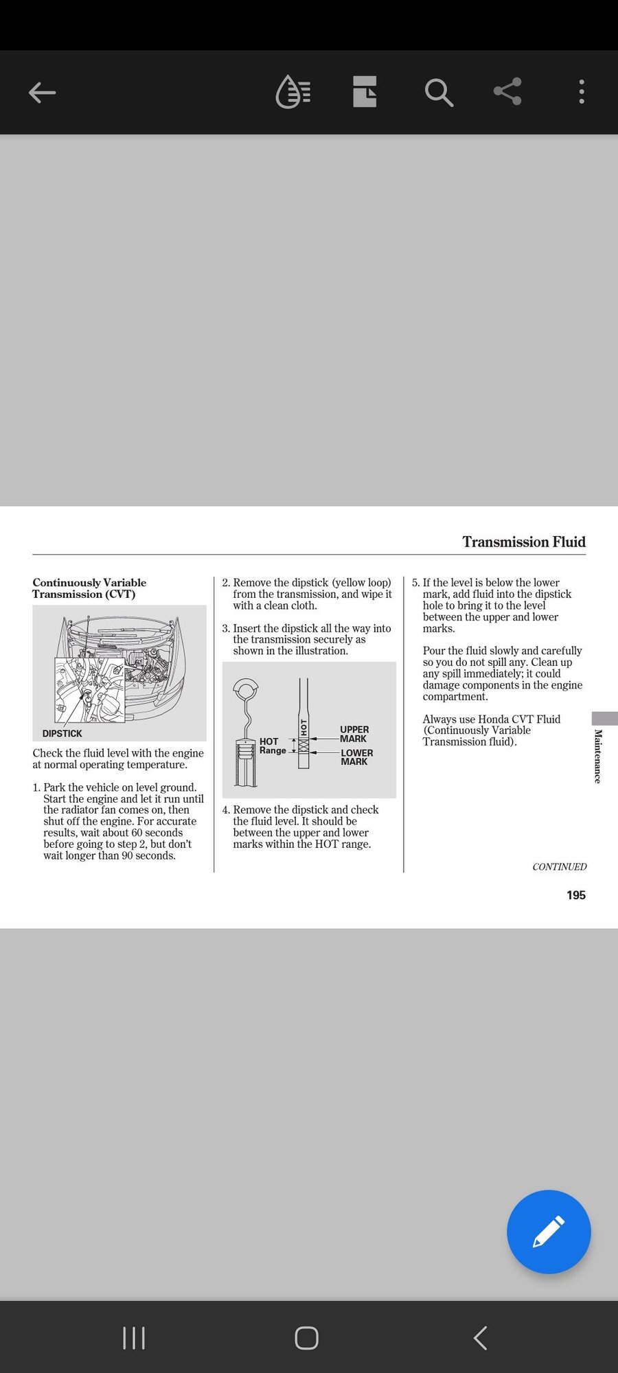

As per the owners manual? On level ground, car hot but off, in park.
On the steepest hill I could find. just kidding.
yes according to the manual.
