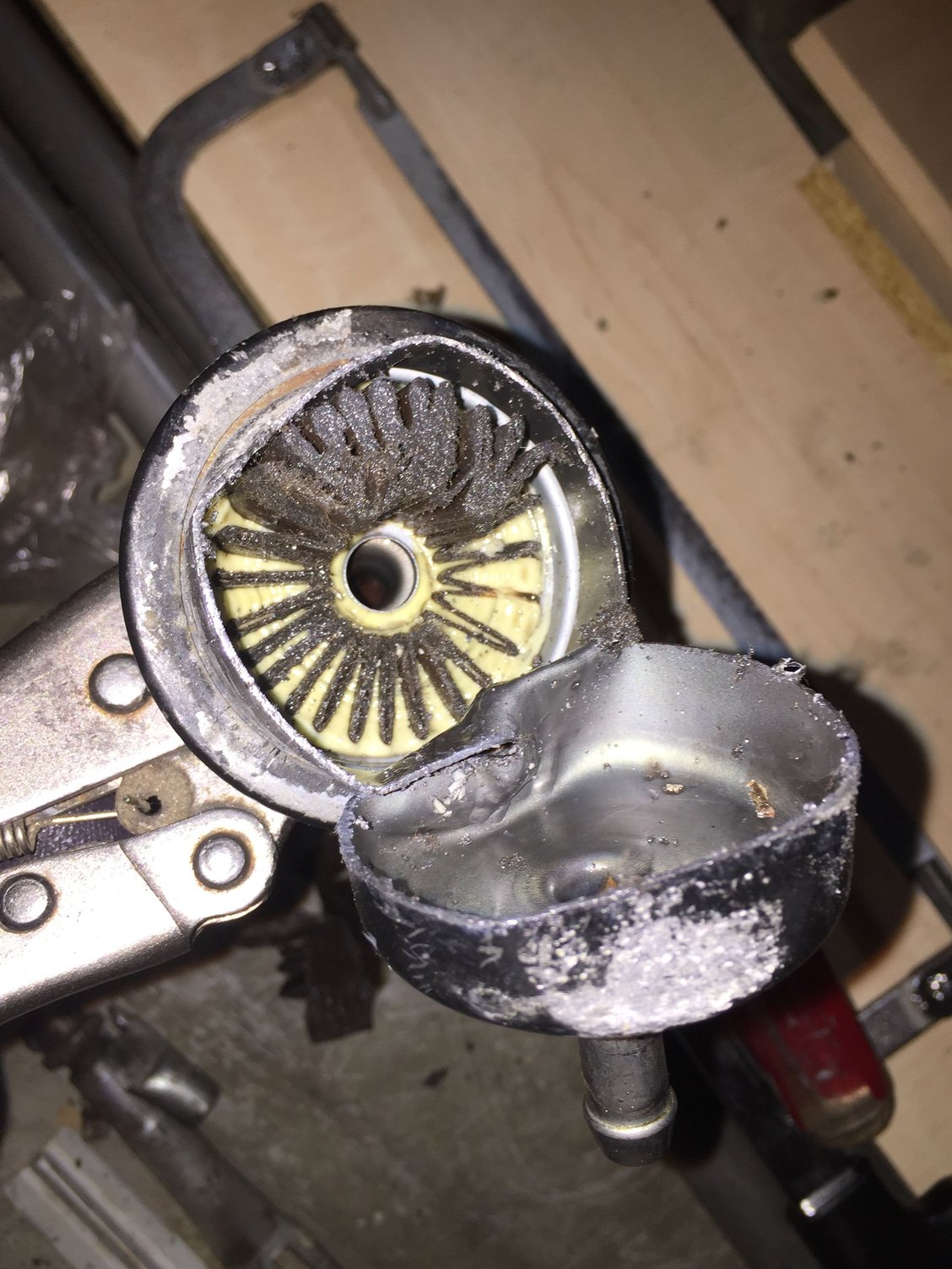

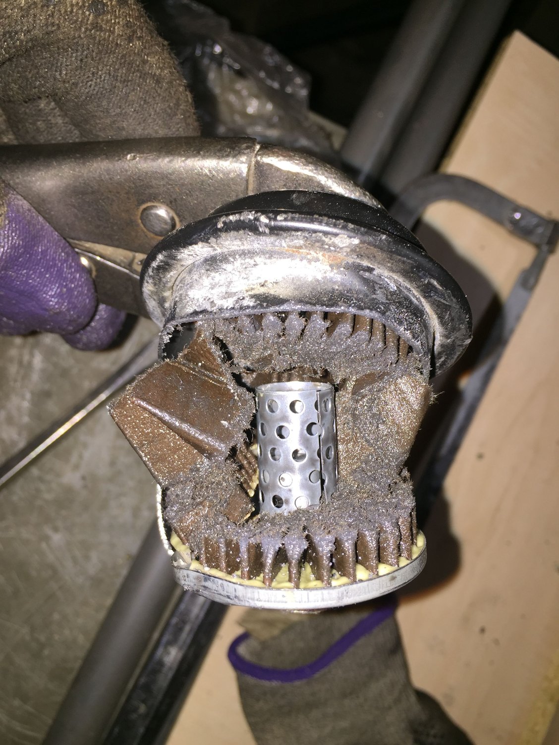

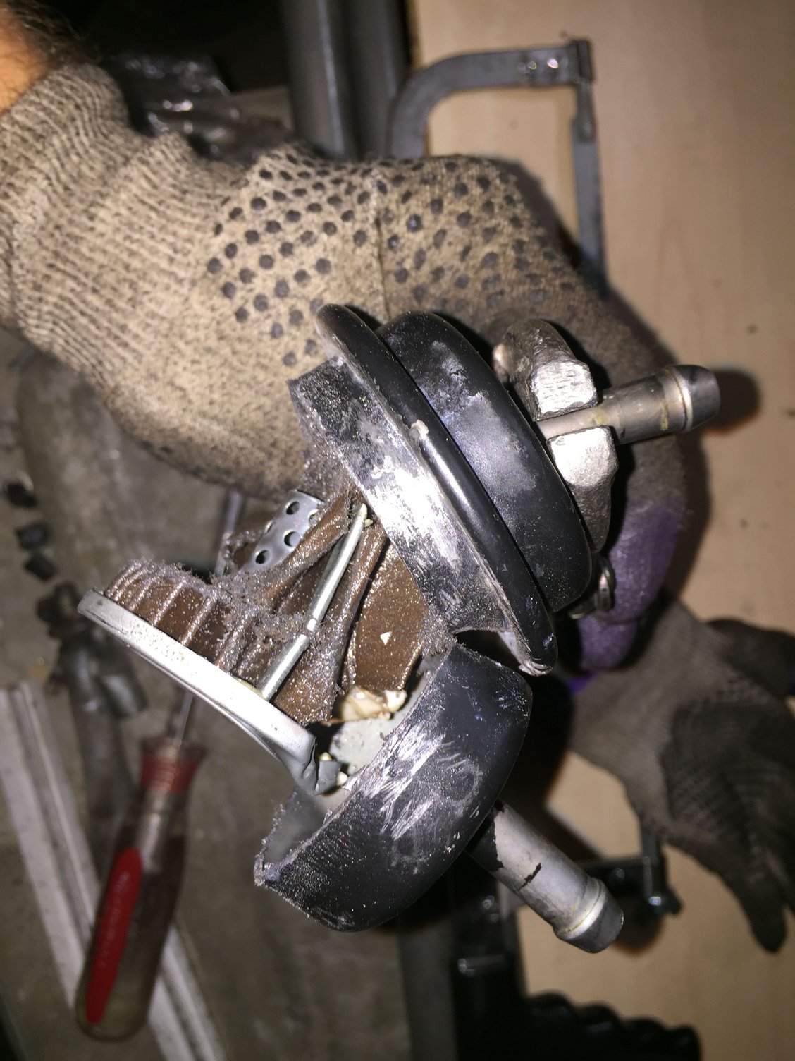

Its been a long time since I logged in figured I would update. I changed the filter some months ago. Its not a bad job if youre patient. I have seen some requests in other posts wondering what the inside of these filters look like. So I hacked this one I took off.

That doesn't look factory

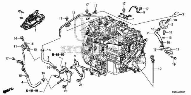

I thought the same, but then again I haven't dicked around with 9thgen engines. Looks like it is. #5 on the diagram is the AT filter. P/N 25430-PLR-003 for you folks looking at this in the future

Yeah its factory. I should of took a pic before hacking it. I thought of it after the fact.
The replacement looked exactly the same although not from honda. Got one from rock auto. Ill put a new one in every other fluid change or whatever. IDK yet.
