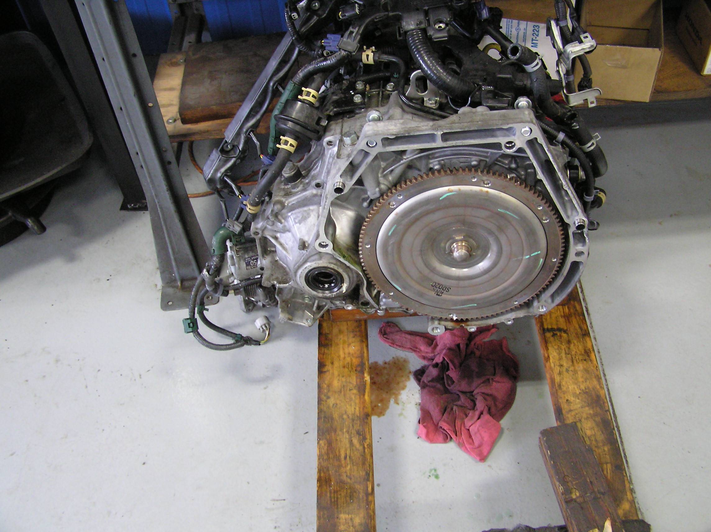

Not sure if this will help you any, but here's a pic of the backside of the drivetrain, out of the car.
You can see where the OE inline trans filter is.

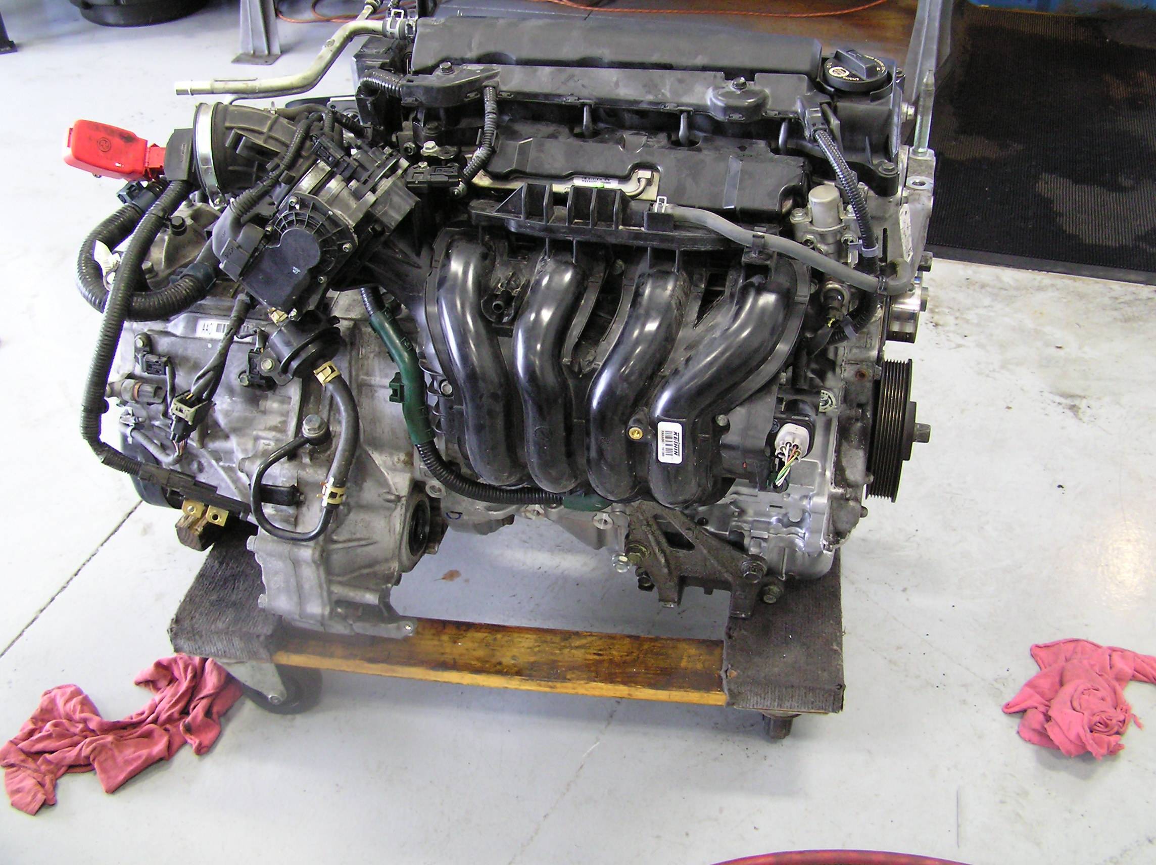

Here's a pic with the engine out of the way
There isn't any cooler lines at the radiator to tap into, they are all on the trans itself. You'd probably need to use these pipes at the original filter, use long hoses and make a remote mount.
The cooler is mounted on the front of the trans.
FWIW, at the shop I work in, we do not replace that filter as part of any regular service.

That filter sure is hidden away! Thanks for the pics ! I peeked again into the engine and scratched my head as to where I would route hoses for a service convenience. Space is so tight! For now I think I will just do a fluid change in the near future ( understand from here that the new fluid DW is current) then muster up the courage for a filter change next year sometime. It seems the filter change would just be a conservative action on my part.
