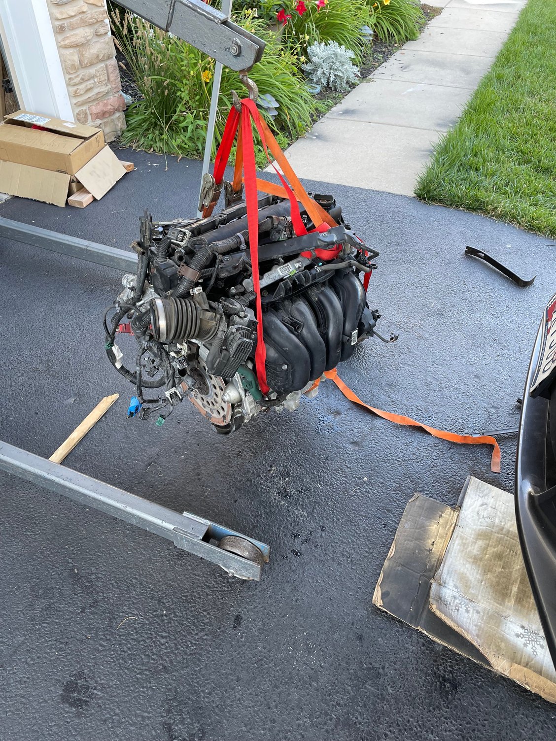

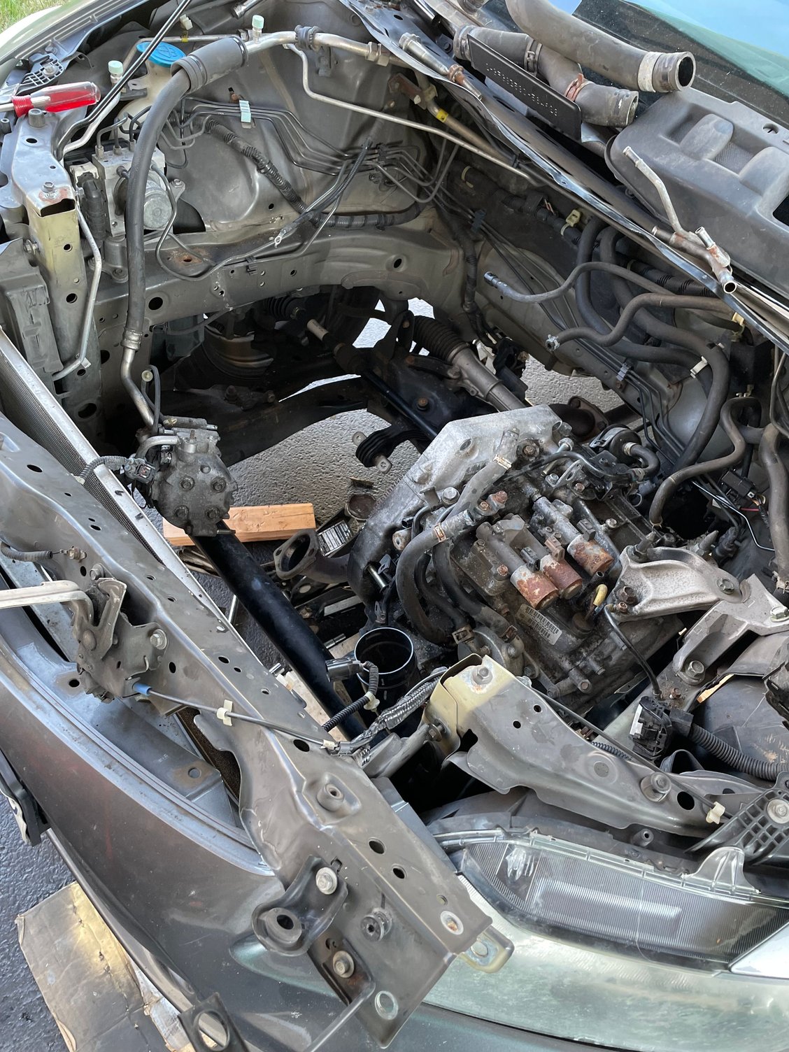

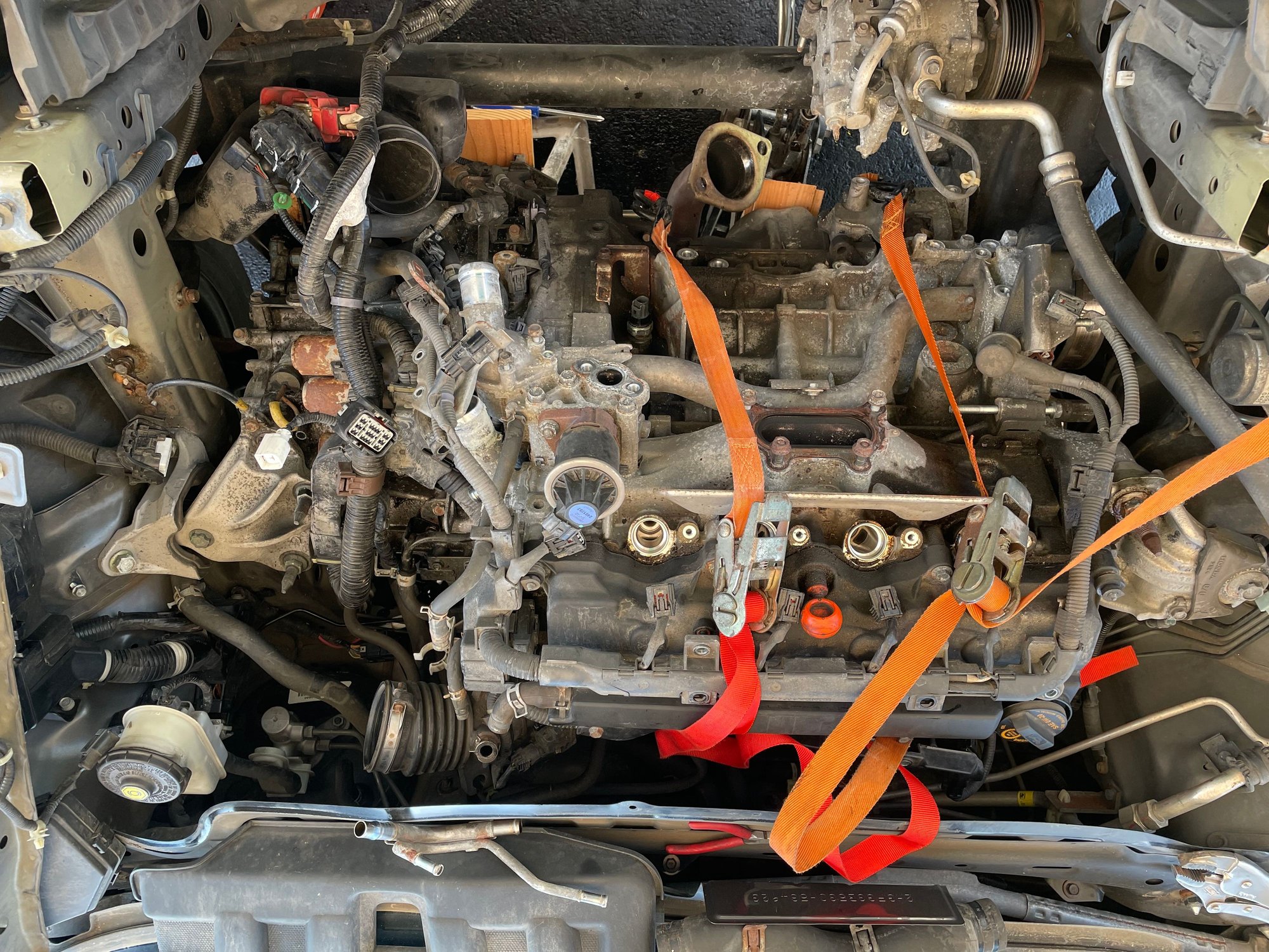

Yep, from the top. So I had to remove the radiator/fans to give me enough room I also removed the cowl panel extension. One 'gotcha' that I ran into was I should have removed the crankshaft pulley bolt, it was getting hung up on the brakelines and I was lifting it out.
Engine out!
Ready to lift
