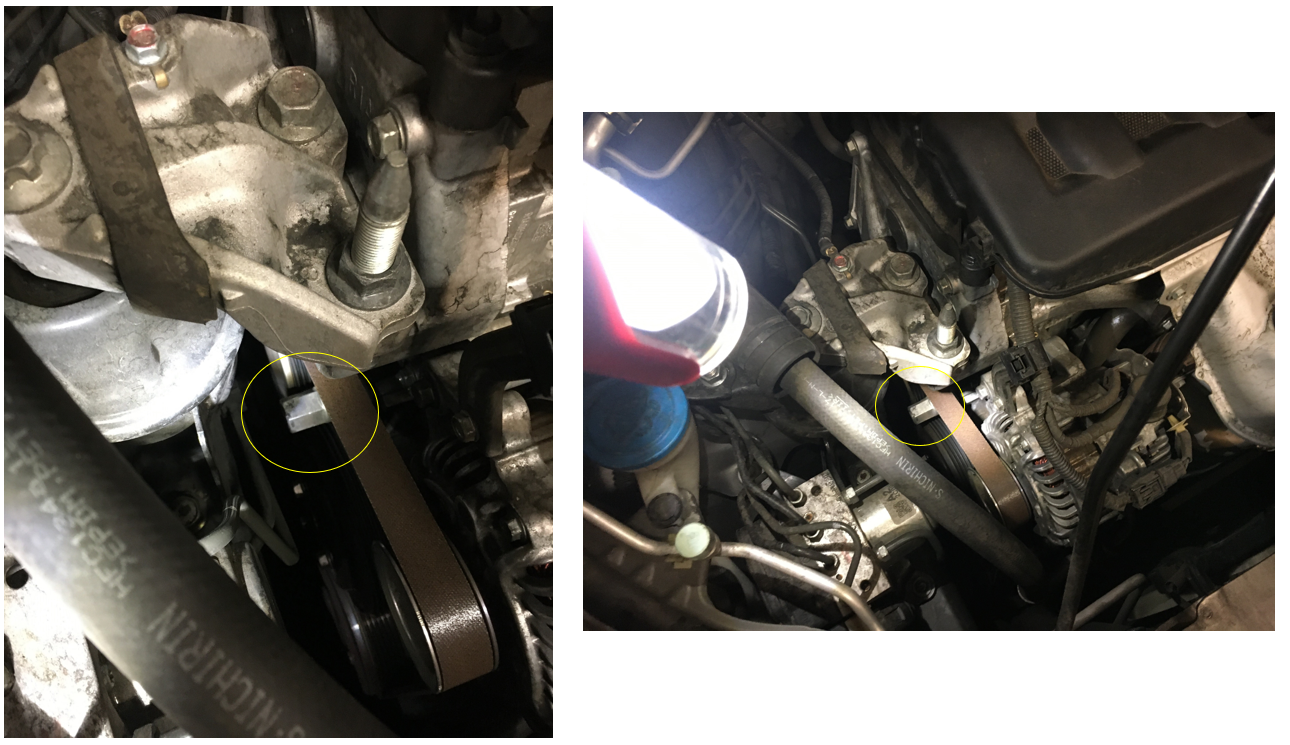

So whenever the car is cold (usually mornings or sitting for a while), when I put it in reverse I heard a loud rattle noise coming from under the hood. It usually occurs or is loudest when the car is cold and i also have the air conditioner running when i put it in reverse. It isn't as noticeable in drive and eventually goes away. Also, when the car has been running for a while or is hot, the noise doesn't occur at all in reverse (even with AC on). I looked under the hood and I THINK its coming from this component. Anyone have any experience with something like this? I had a mechanic look at it when he was doing an oil change but wasn't able to figure it out (probably because the car had been warmed up and i wasn't able to leave it there for the problem to be replicated).

I have had the same issue, same year and EX, and have taken to starting my car a few minutes before I'm ready to leave. Unfortunately, I haven't found a fix.
Mine's worst in reverse with the AC on, but it's still there without the AC on.
I've read about replacing the tensioner, the idler pulley, and/or the belt as possible fixes, but have done none yet. I get annoyed every time I leave my house, because I have to back up a hill of a driveway to get out, and usually forget or don't care enough by the time I get home.
I'll update if I try replacing any of those possible problem parts, but I doubt I'll get to it anytime soon. The belt looks fine, and the pulleys aren't wiggling!

On one of my vehicles I had a terrible rattle while turning and not moving and also sometimes when the a/c was on. My issue turned out to be the accessory belt tensioner was basically maxed out due to the belt stretching over time. I believe the tensioner also wasn't OEM and didn't have as much travel. I replaced the tensioner (with OEM) and a new belt, never had the issue again. Could be something similar to what you're experiencing. A new belt is cheap.

Yeah you guys got it right... i actually just took the car to Honda last week because I couldn't stand the noise anymore. It was the tensioner. The noise is completely gone now and I can back up my car in peace and quiet again.

I replaced the belt and tensioner yesterday. My annoying noise is gone too!
Idk which was the culprit for sure, buuuuuut the tensioner was gross the boot that holds the hydraulic fluid leaked I guess.
