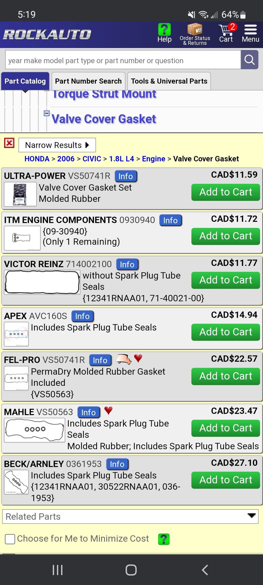

I have Google replaced spark plug seal and it only shows me how to do the top which comes with the valve cover gasket but not the bottom of the spark plug tube seals I can't even find a part number for the spark spark plug tube seals I don't see anything in any of the books or anything that's why I'm on the Honda forum asking if anybody has fixed this issue themselves since I've seen this posted over and over again and nobody ever has the fix

did you ever locate the tube seals? im having this issue rn and i cant find em since theyre not in the valve cover like they normally are

There's 5 different options on rockauto
