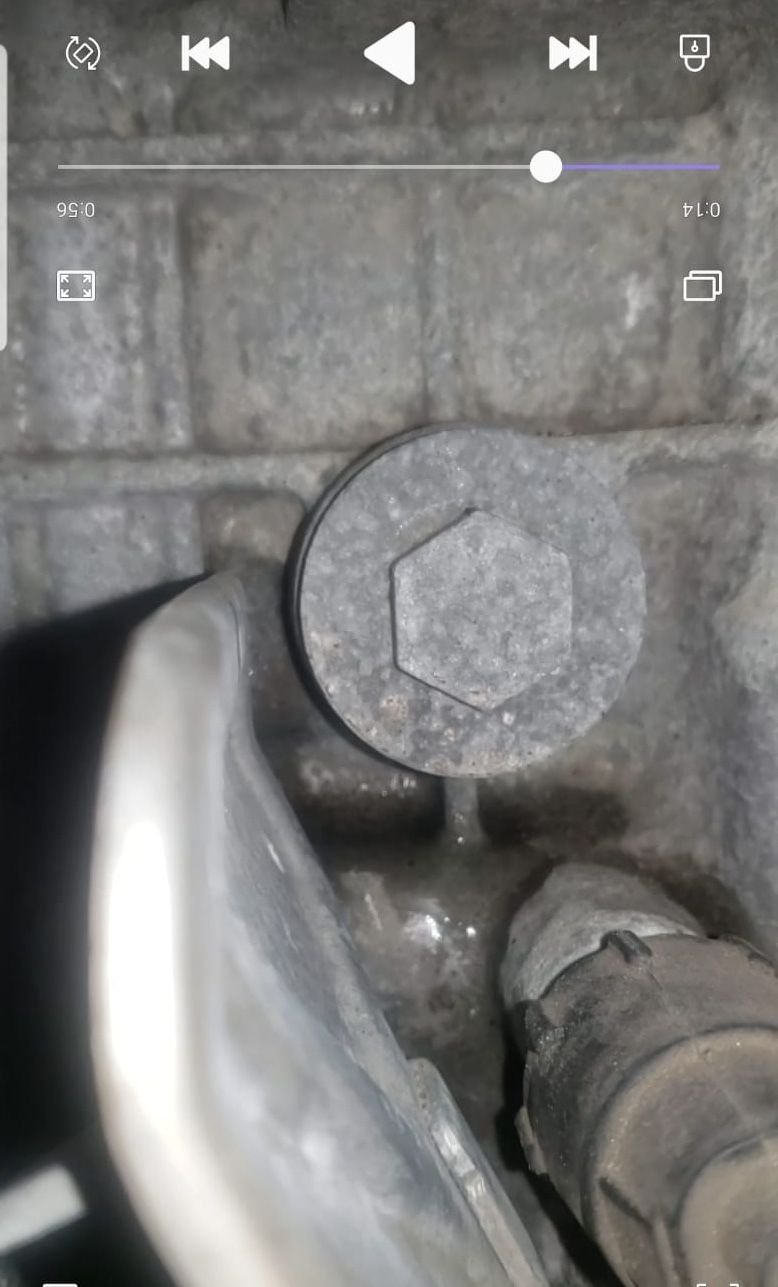

My 07 civic ex started leaking antifreeze last night. I found where it’s leaking from but I don’t know the name to get the part. My cousin said it’s the freeze plug but when I google the part or search part from advance auto it’s not pulling up the screw. Can anyone help me name this part. Not sure if I need the o-ring or what not but I just need to know what to buy. Thanks

Engine block drain plug
bolt p/n: 90001-PM3-003
sealing washer p/n: 90401-PR4-000

I go to part store and they are telling me it’s not drain plug.
drain plug is for oil is it it? Correct me if I’m wrong because obviously I am on here because I don’t know much about cars but I am leaking antifreeze not oil?

Engine block drain plug for the coolant jacket. I pulled those part numbers from a Honda parts diagram.
#17 & #24 on the diagram above coincide with the bolt to which you're referring

I mean, it's quite a specialty bolt. You may need to get one from Honda or a Honda OEM replacement. The website links I posted are from a legit site, I've ordered from them many times. If you can afford to wait, it's worth the savings over a stealerdealership
