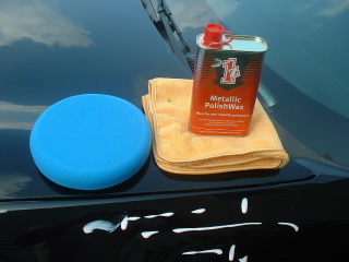

Agreed, washing and drying is the way MOST swirls return. Here ia a great article on washing and drying the CORRECT way. Enjoy
Jon
How to wash and dry

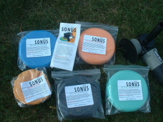

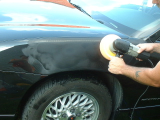

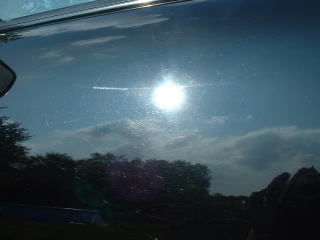

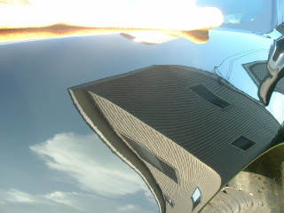

As for removing the swirls. It can be done by hand but a PC is the easiest and best way to remove the swirls.
PC with Sonus Pads from Autopia
I would recommend 1Z Or Menzerna polishes to REMOVE the swirls.
Here is a couple of pictures on removing swirls I did on a black Grand Prix GT.
