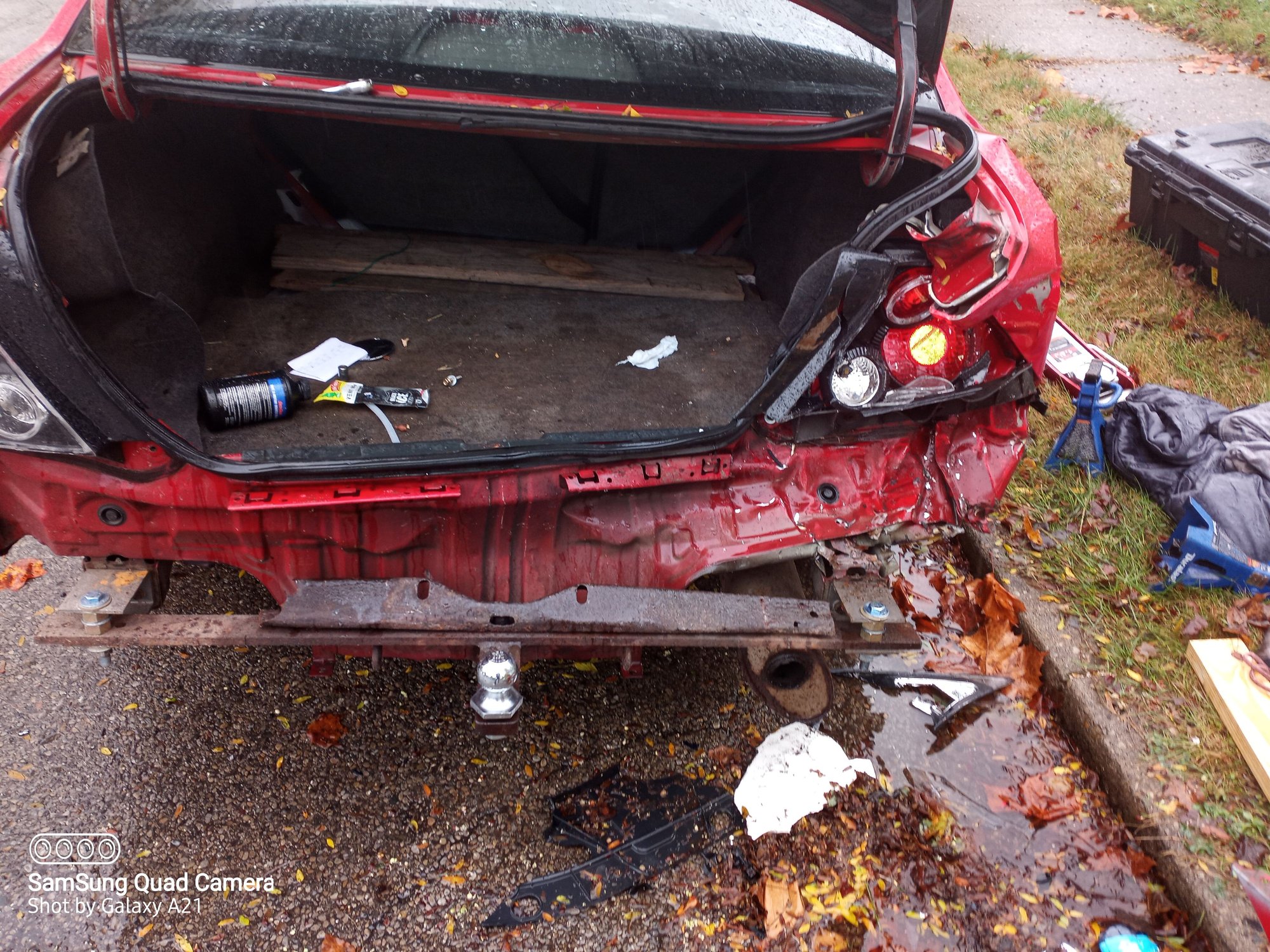

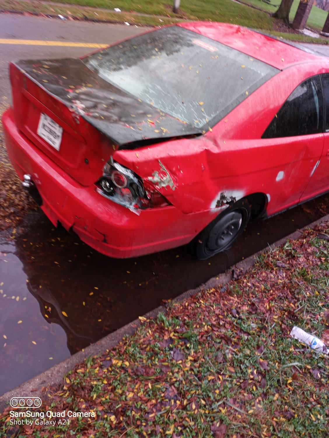

I have a 2001 Honda Civic EX VTEC I had it parked on the street someone rear-ended it so my idea is to take a 2005 civic ex vtec
2001
2001
2005
2005
that I purchased with a blown engine and drop the engine and trans together by the subframe out of my 2001 and install it in the 2005 if I remove everything from the 2001 engine bay and put it in the 2005 engine bay is this compatible completely If someone knows for sure let me know I would hate to get Knee Deep in grease and parts just to find out I have to start all over

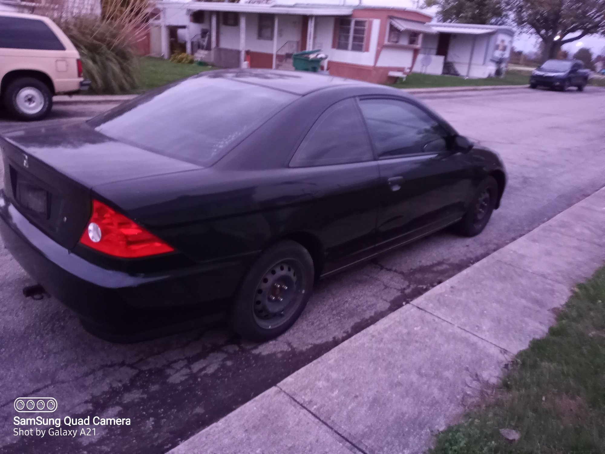

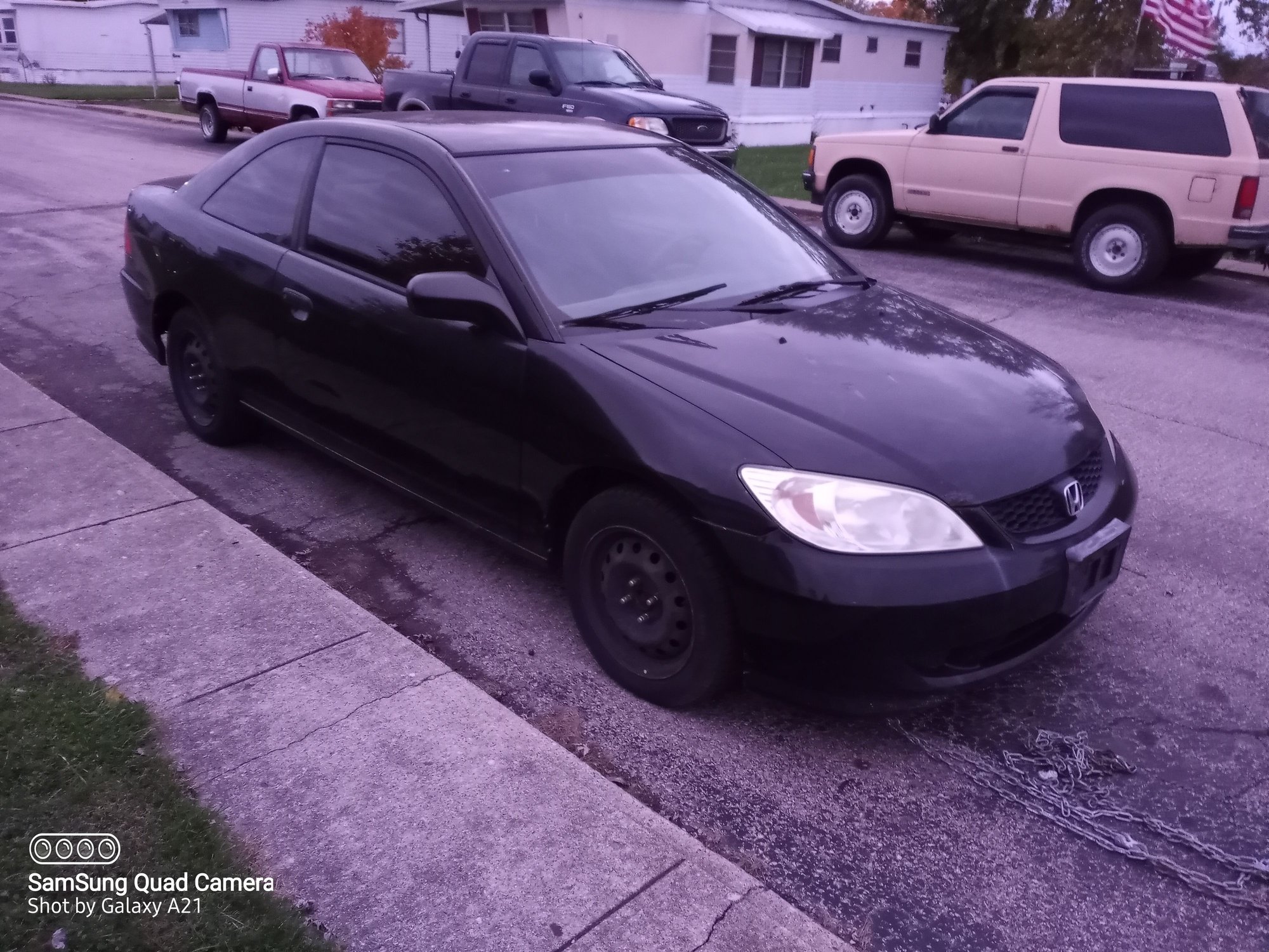

So the 05 isn't vtec but I just put the 01 with 40000 in and the trani with 20000 as well I'm in the process of swaping them to the 05 now and plans for the 05 are to rebuild it and make it even faster than it was before
