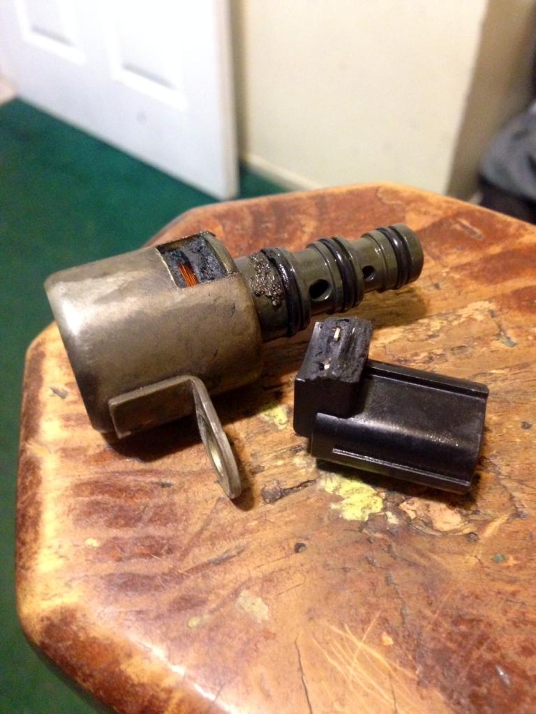

This thing was jacked up.
Replaced it and no more issues!
