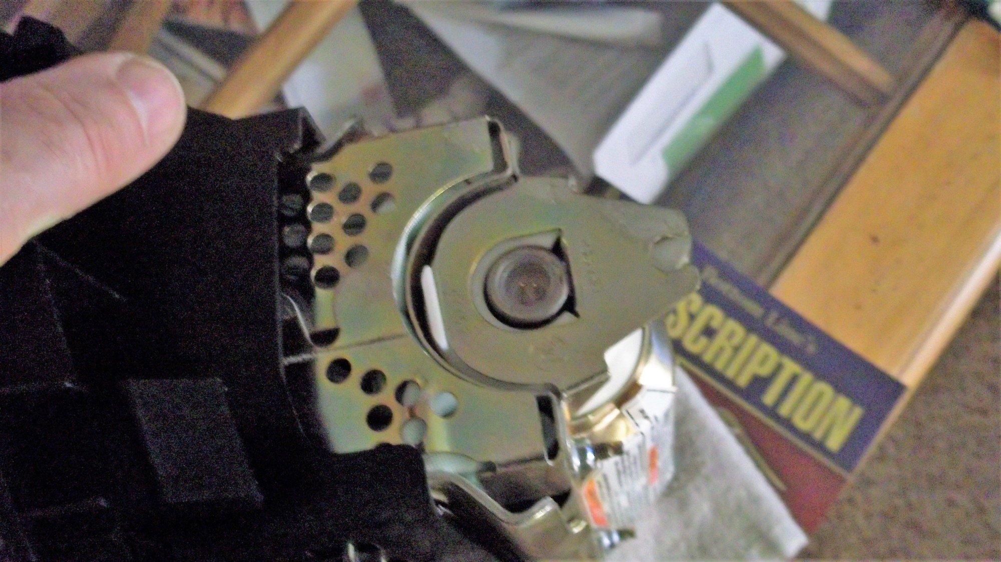

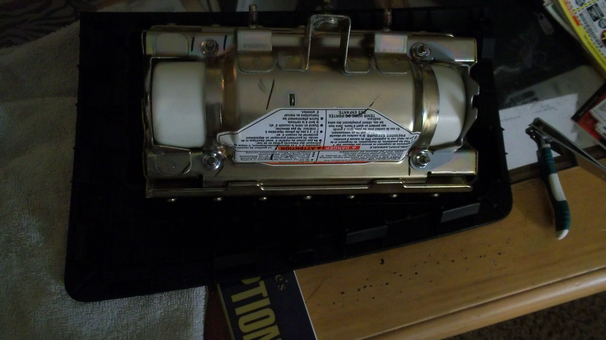

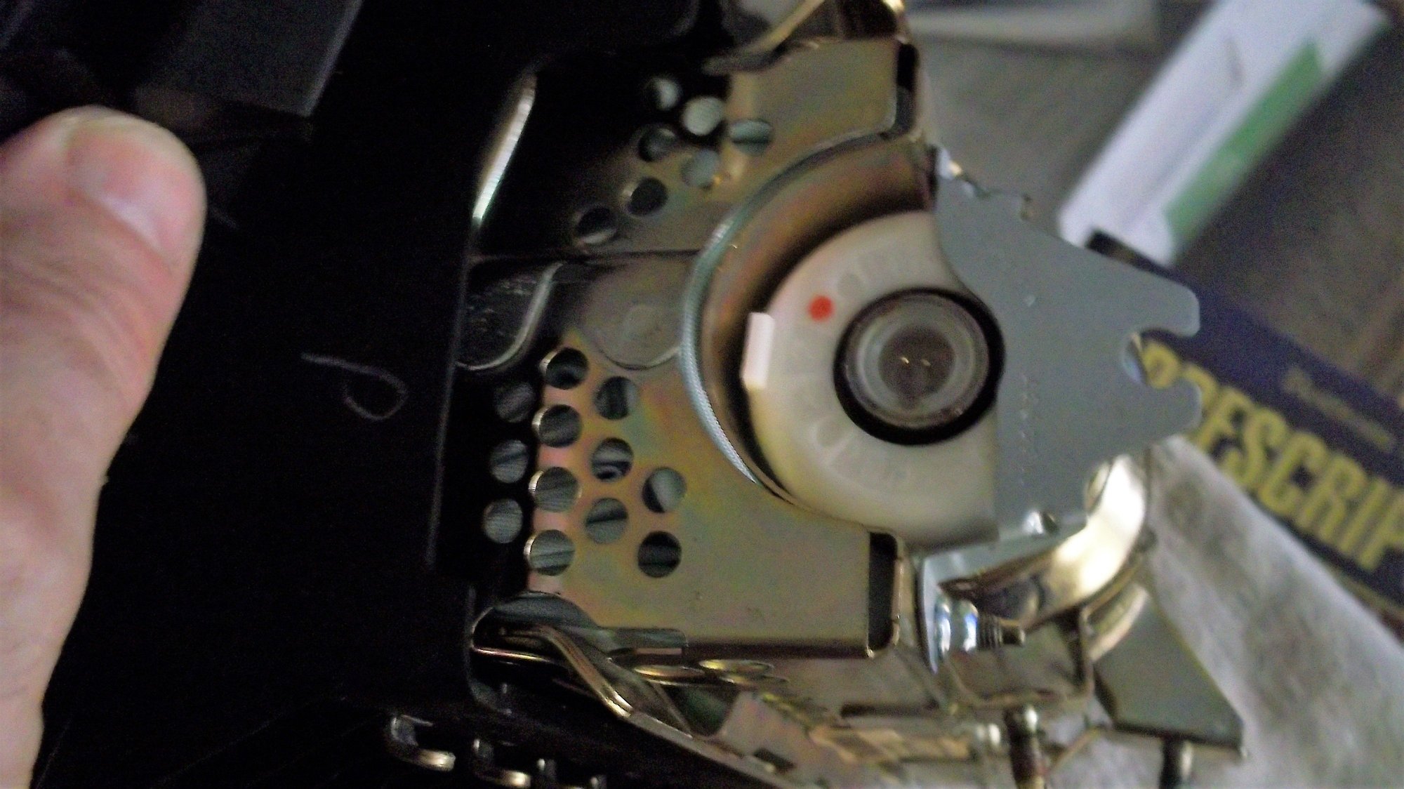

OK, I got the bag out and when I was removing it here is what I found. The airbag has a place for a 2-wire plug on each side. There was a yellow 2-wire plug just hanging not connected to anything. The air bag only had a red 2-wire plug on one side, the other side had nothing plugged in. I'm thinking the yellow 2-wire plug goes to the airbag side with the missing connector. BUT, I'm hoping someone can confirm that both the red and yellow wire connectors go to the air bag. Here are a couple pics of the wires and connectors on the airbag. Here are the pics:
If I'm not mistaken it's the yellow wire (providing it goes to the airbag) that use the 2 ohm resistor for testing. What would I do with the red wire for testing?

Also, the red 2-wire plug came out hard and snaps in hard. The yellow 2-wire plug pretty much slips on/off and doesn't snap in place. Makes me wonder if the yellow wire plug is the correct one (which I think it is) or if maybe the socket it plugs into is wore out, etc...
Just soon not connect the battery back up until someone chimes in if possible...

Don't touch anything else. Take it to a Honda dealer and don't do this yourself. You could be injured or killed or mess up the SRS.
