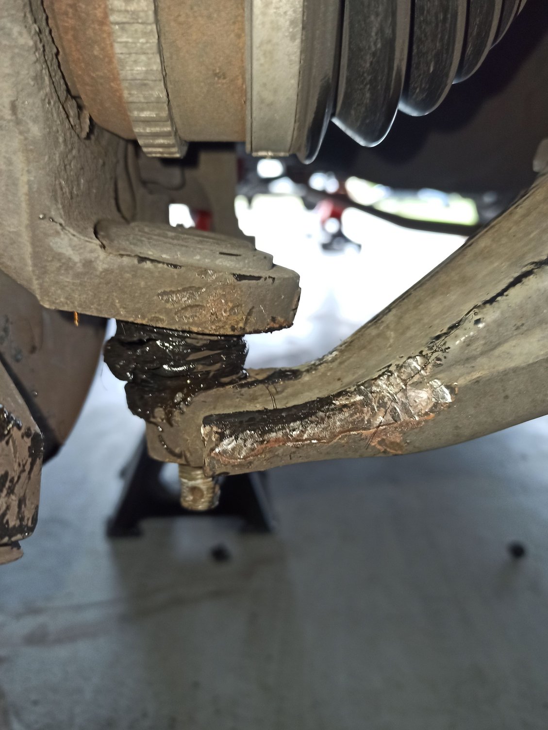

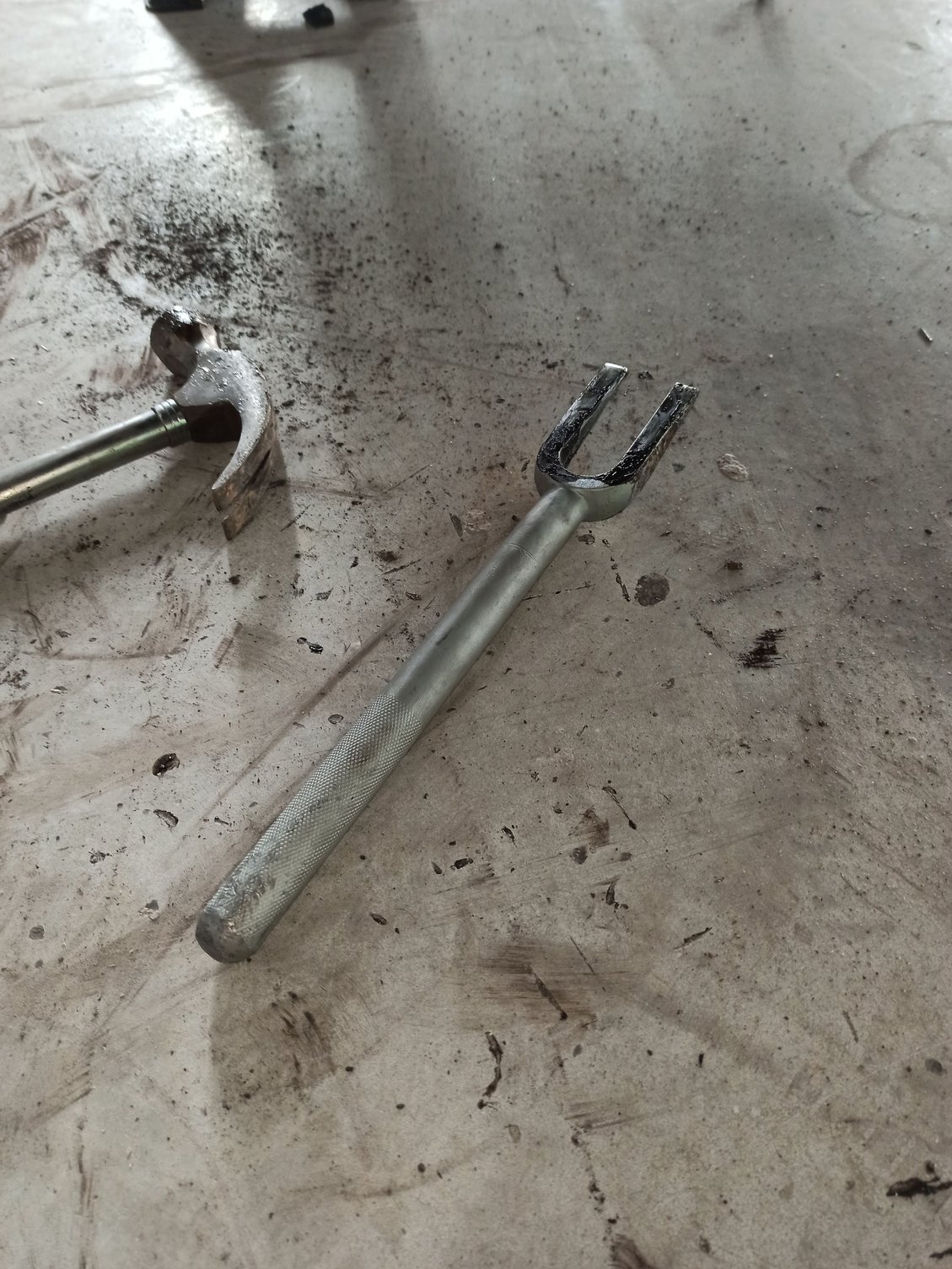

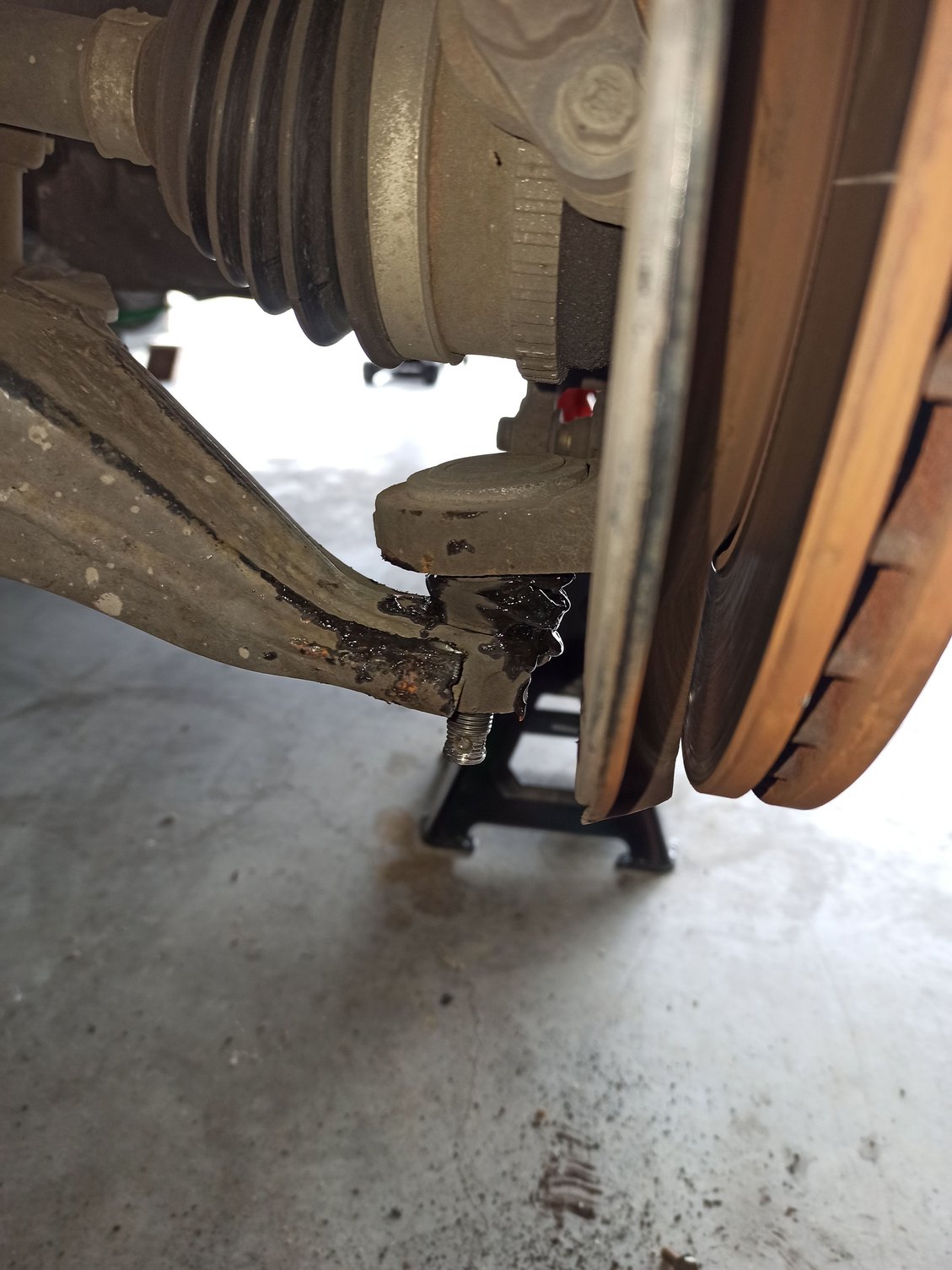

Hi there, so im in the process of changing my clutch and I cannot for the life of me remove the lower ball joints, I've hit control arm with a hammer very hard, I've used the separator tool which in the process has ruined the ball joints, and Ive hit the bottom of the bolt with the nut on and it has deformed the bolt and the threads, yet the ball joint hasn't moved a millimeter any help as I need to use my car in 4-5 days and I'm getting kinda frustrated

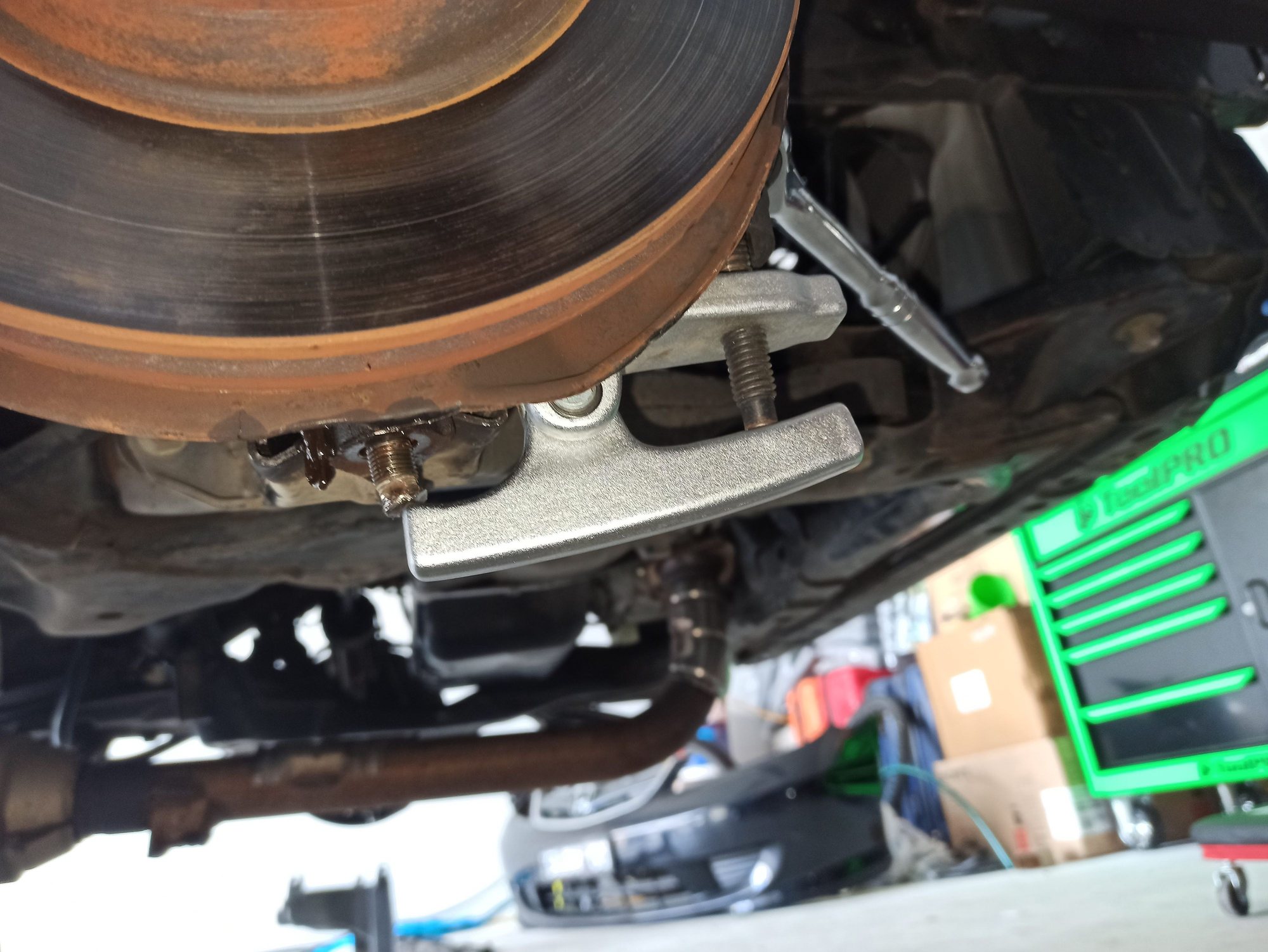

this is the proper tool.
I had to leave it on and tighten it everyday a little bit more, until one day a loud bang indicated the ball joint finally came apart

wow hahahah thats really annoying! i would have thought it wouldnt be so hard as mine arent even rusty. so ill go and buy one of them today, how tight do i do it? or do i just crank it down as hard as possible with the impact?

just be careful with an impact. Like said, it was a loud bang when it came apart. I was in the living room, doors to garage closed.
I was not in a huge hurry, I have other cars

no. the loud bang means the parts will come apart in quite a velocity. Keep fingers away

so ive put the tool on the ball joint bolt, unfortunately i couldnt get the nut back on, and i tightened it down until it slipped off also deforming the bolt, so ive put it back on and tightened it up a lot, and im going to leave it there, of course just to make things even better my ratchet is now stuck on there too

Update: finally got them removed, after a lot of trial and error i decided to remove the boot from the ball joint with a pair of nippers then i turned the wheel to full lock and was then able to push the removal tool much further onto the bolt at the bottom, and then after ditching the ratchet and moving over to a 30 inch breaker bar i was finally able to crack both of them free!
