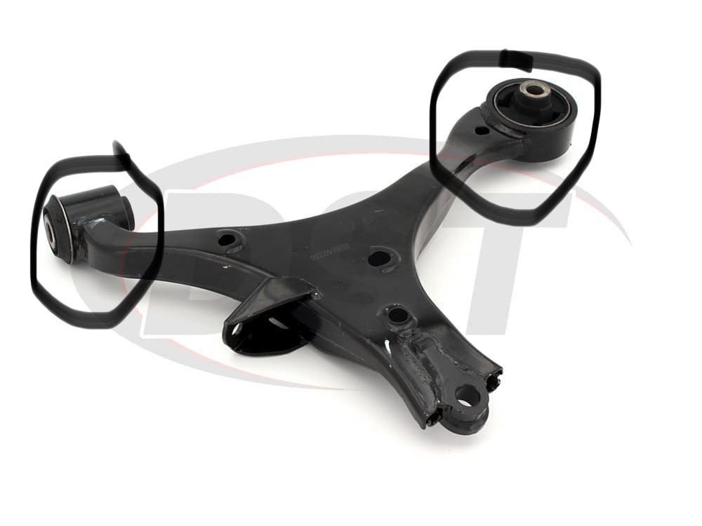

Hello I’m changing out my lower control arm and I want to get new bolts. I can’t seem to find anything online. Would anyone have the bolt size or a part number I could use. I have circled the bolts I need

The TL;DR version, they're both M14 x 91 bolts, P/N 90118-S5A-000
