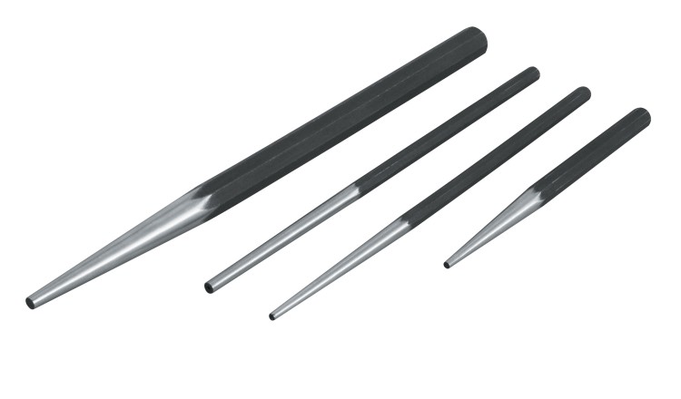

Tapered punches are great for getting holes lined up.
So are screwdrivers and pry bars.
