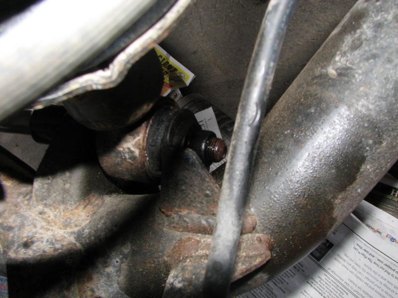

Alright! Went to CT Boutique (Canadian Tire) and picked up some PB Blaster and an IR impact wrench (a 2100G - the strongest in the store at 550 ft.lbs). Neither of those did the trick:
This didn't do the trick either:
Yes, that's a 5' steel pipe. It just ended up rotating the bolt/bushing inside the rubber eye, which did nothing to free it up. Eventually, I sorta gave up and started fixing a broken toy.
After resigning myself to having a local shop do the bolt extract-grease-reinstall job, my brother in law popped by. He runs a local motorcycle shop and so he took a look. He left and came back with a few tools including a better version of the IR wrench (2135Ti). While I adapted his wrench to my air hose fitting, he heated the bolt with my map gas torch, then hit it bigtime with the PB Blaster and finally worked it loose with some IR double-hammer persuasion!
The trick he said, was to heat the ends of the bolt (since that's all there was to work with). "Heat is your friend", he said. I'd tried heating it last night but I was not focusing on the ends of the bolt itself and I didn't heat it long enough.
