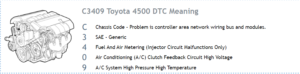

Edit: I found a little more info on that C3409 Code, but it applies to Toyota vehicle, i Honestly don't know if it works or be valid for my Honda...
