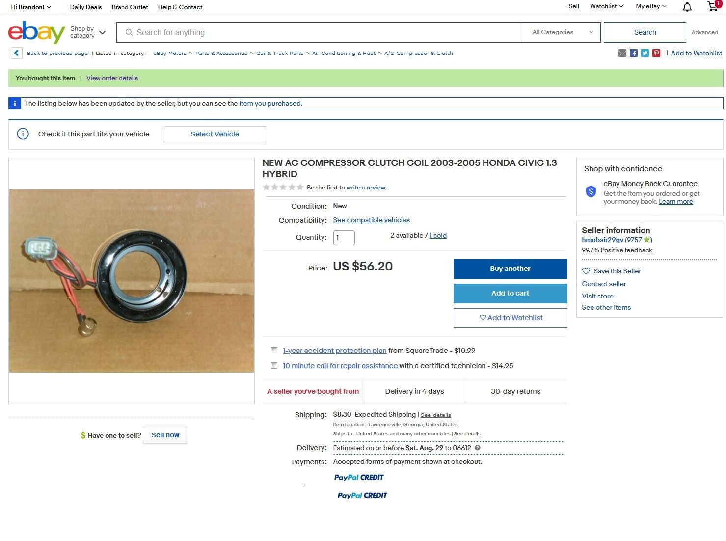

Now, if you are cheap and eat your cereal with a fork to save milk, then you can get away with just replacing the magnet on your compressor. I found a brand new one on ebay for about $50. For some reason Ebay was the only place I could find this part but I guess you could search for Sanden TRSA09 Coil or Magnet and maybe find it idk?
Take the passenger wheel and wheel well off to make room and you don't even have to unbolt the compressor or discharge the system to do this repair. Only special tool you will need is a cheap set of two or three jaw pullers, and a set of snap ring pliers from harbor freight. Unbolt the clutch nut off the front of the compressor, pull the clutch off, remove the snap ring holding the coil to the body of the compressor and replace. Snake the old wire through or reroute your new one over if you are lazy and dont want to f with pulling old wires out. You may have to splice your old coil plug onto your new coil, my new one was ever so slightly different, use good water proof butt connectors for that and zip tie your wires up nice and safe.
