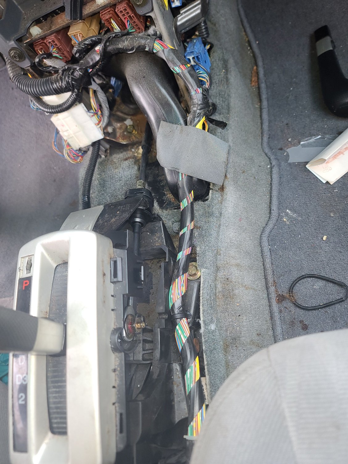

Post a picture of the interior cable end

Re: Help with 05 civic auto transmission issues and install
That silver part that's bolted to the shifter should be threaded so you can adjust the length of the cable
Old Aug 17, 2021
msv96's Avatar
Joined: Mar 2020
Posts: 18
msv96 is an unknown quantity at this point
it's not threaded I can pull it in and out. Is that what you mean?
Old Aug 17, 2021
Colin42's Avatar
Posts: 9,645
Likes: 1,283
From: Barrie, ON Canada
Rep Power: 223
Go download the service manual on the last page here:
https://www.civicforums.com/forums/1...ispreloading=1
Starting on page 1115 it has all the information on how to remove, install, and adjust the cable. It's a little more involved than what I was thinking.
