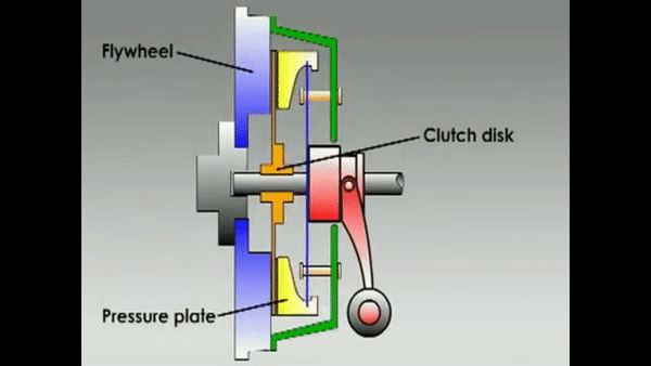

The clutch, like I mentioned in post 6, albeit in different terms, has the job of getting the transmission input shaft to match the rotational speed of the crankshaft. How does it do that? The friction surface of the clutch disk meets with the flywheel (attached to the crankshaft), and the pressure you feel in the clutch pedal is the resistance of the pressure plate (refer to the gif below)
Now, when you get into the realm of stage 1 clutches over OEM, the main difference is going to be the pressure plate. It'll have much more clamping force, and you can definitely feel it in the clutch pedal. Possibly more heat resistant material on the friction bearing faces, too. Now, when you get into things like stage 2 and 3 where you have "pucked" clutch disks, not only is the pressure plate gonna have more clamping force, but since there's less surface area for the pressure plate to act on, more pressure per puck will be exerted onto the flywheel from the clutch disk. The friction material is also going to be performance based -- probably some sort of metallic ceramic that has the capability of biting harder and play nice when they heat up. This is also a double edged sword, since the increase in clamping force makes clutch engagement much harsher, and less friendly with regards to daily driving, for some.

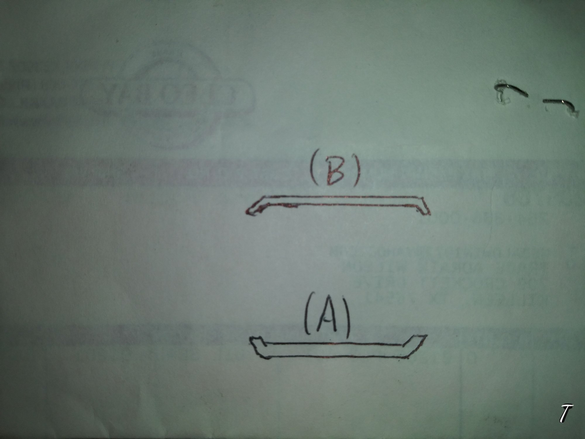

Hey man i have a question..i was working on my 02 civic transmission and the 2 main washer fell off when i was lifting it out of the housing , i know one of the washers ate flat and one has a different shape , i made skatch on paper for demonstration purpose so you can tell me the correct way to put it on the shaft.
it doesn't shape exactly like original washer but just shspe like this. (A) shows it with the belly turn downwards with the other flat washer on top and (B) shows it with belly turn upwards with the flat washer on top as well..please tell me which way it should turn.
