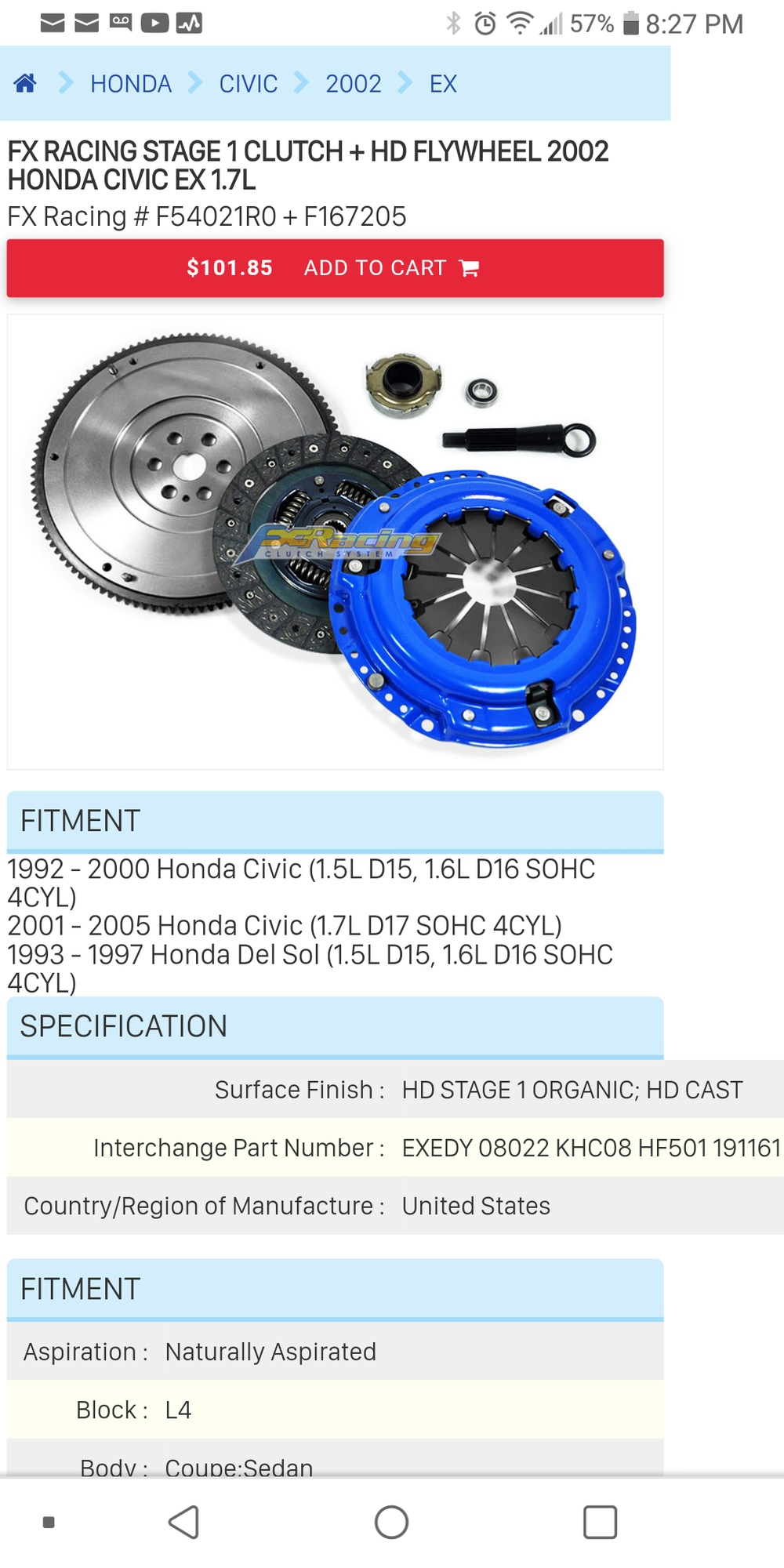

Does anyone have any experience with this manufacturer by the name of Fx racing clutch system? And doe you think the price for this kit is a good price. My 02 civic clutch is slipping,the mechanic said that my clutch is slipping I'm thinking of changing it. Look at the picture below.

Never heard of them, used the excedy kit in my other 05 and it was good.

Ok, i heard good things about Exedy bran but the prices for the full kid with friction dis,pressure plate and flywheel are close to $300 on Amazon.im trying to fine something in the $180 $200 region. But exedy dont have anything of that price that with flywheel included.

If you're not running more than 140ft-lbs or planning on it (only spec I could find) just go exedy OEM. I thought it was a clutch Masters fx series clutch, but it's fx racing. No clue what that company is. Lol
If you're planning on running higher torque, ACT or exedy stage 1 wouldn't be bad. When I was running boost making 155whp (wastegate actuator stuck at 2.5psi), a stage 1 was overkill for me

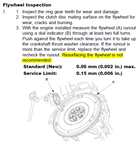

Just wanted to add that the service manual states flywheel resurfacing is not recommended. I'm sure it could be done though.

From the service manual...
I got yah..
Old Sep 6, 2019
Rep Power: 513
Re: Clutch kit system
I wonder if that's specific to the OEM flywheel

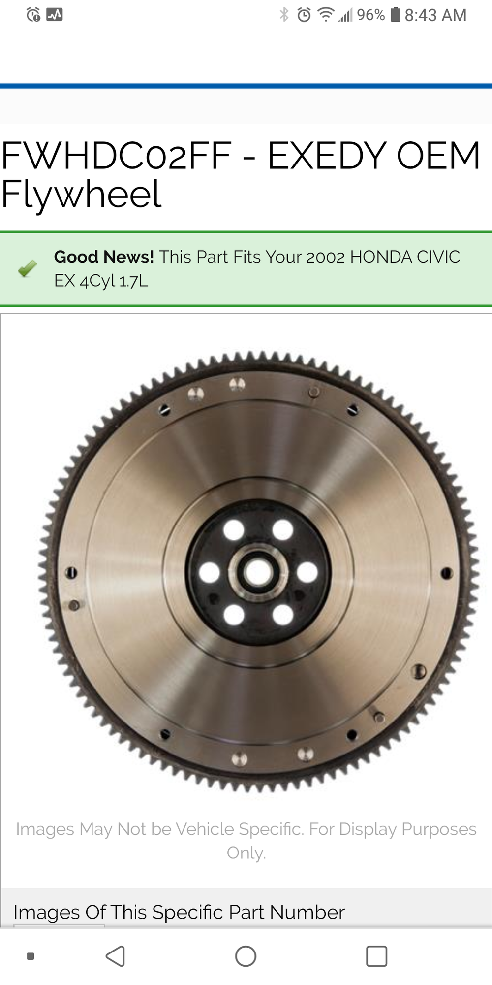

Flywheel
Is this a single stage flywheel or 2 stage..? I want to have mine resurfaced but they told me its for the 2 stage to have resurfaced.
Old Sep 9, 2019
Rep Power: 513
Re: Flywheel
Clutch is stage 1, 2, 3, etc.
Flywheels just.. OEM weight or varying lightweight versions
That flywheel you posted is an OEM replacement (probably 17lbs)
