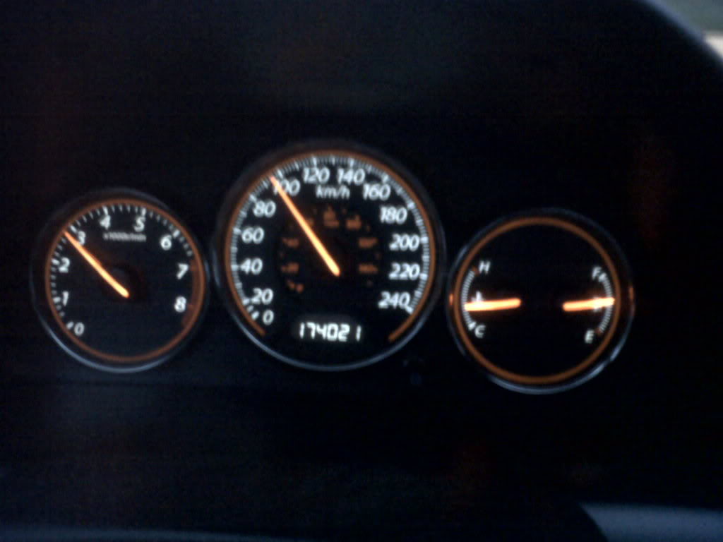

Re: Newb with a question..
You have an EX transmission now. Gear ratios are indeed different between the models but only the EX differs from the others.
This is my car in KILOMETERS per hour so this is roughly 60 MPH, it is an EX.
at 80 MPH I've crossed 4000 RPM.
I think you are right, I looked at my rpm's today when I was coming from work, and it was exactly like yours. damn, I really dont feel like taking this rnas off again. Is it okay if I leave this one in? Just the gas mileage issue, not the engine right?
It shouldn't make that big of a deal for your gas mileage, on freeway driving you'll probably see a change though. I actually think the lower gears in my EX probably help me where I drive, on curvy roads, so I can stay in 5th for even the slower curves. 37-38 on 55 mph roads, and I drop to 35-36 on 65/70 mph roads (In the summer).
