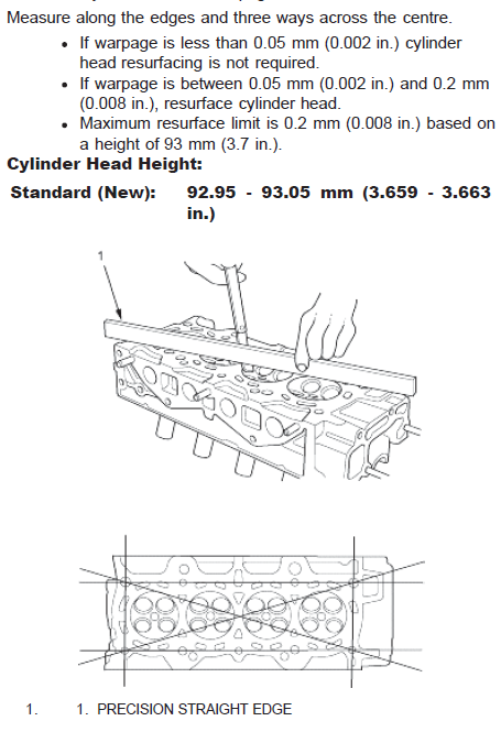

how often are the heads warped on these guys? does it often need a machine shop? what are the tolerances for out of flat?

Head should be checked at a machine shop.

the headgasket kit is what was 70 bucks. i ordered it from rockauto yesterday.
do you know the specs for out of flat so i know if i need to take it to a machine shop?

I have never had one that didn't need milled.
Specs are in the service manual which can be downloaded for free.
https://www.civicforums.com/forums/1...updated-3.html
