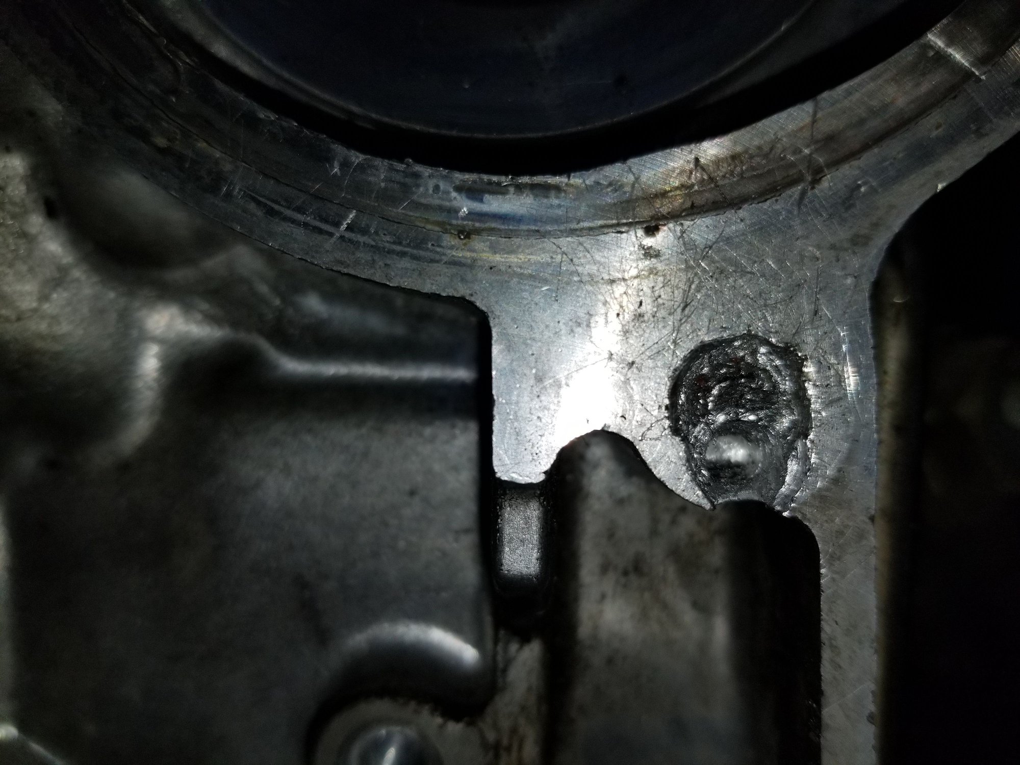

Bottom right bolt for water pump housing
Ok so here it is. First let me mention I've solved my valve cover issue, thankfully. Thanks for your input on that one.
On to the broken bolt... so my friend, who is more mechanically inclined than I, thought he could try to drill out the bolt. We ran into the same issue as a guy in another thread with this problem, because it's so hard to access and get a straight shot at it. Now I'm convinced this thing is screwed to hell... i don't even know what to make of this pic. One idea i had is to screw the other bolts in and use some kinda sealer (Hondabond? Can someone explain that to me?) to hold it in place. Then start going to church and get real good with Jesus, then I'll ask him to make sure the water pump never fails. Or just tell the person i sell it to that the mechanic i went to did that Now, before you go ripping on me about the damage, remember that I'm not a mechanic, and my friend that drilled the hole knows more about this stuff than i do, so i was trusting him. Again your help is appreciated guys

Re: 2004 Civic DX issues
This does not read like a happy ending.
I think one of the holes on the right can be drilled out all the way through the backside and you could use a nut on it
The other three holes would need a repair kit made for aluminum block, as you noted a hole saw though the inner fender or remove the engine to install.
Pretty certain no amount of sealant is going to hold for long,

Just edited to the last response to upload the pic. What do you make of this? I'm convinced that I should just sell the car as is to a mechanic or junkyard and cut my losses lol
Well while that looks horrific, might be still salvageable with some skill.
Do you have access to a dremel with a thin cutting disc and a steady hand.
I would put a ever so small slice up/down on the bolt and then see if I could turn it with a flathead screwdriver.
I would not worry about going into the block above the broken bolt a little, you already took care of the metal below the bolt so much it’s like a guide path for the blade.
Remember the blade with cut through aluminum like butter, but spark and stall on the actual bolt so go slow and keep it sparky..
Update: we fixed the issue. Got our hands on a right angle drill and got that sucker out. Then used something to re thread the hole, stuck a screw in there and held it down with two nuts. I'm keeping the faith that it'll be enough. Thanks for all your help everyone!
Update again... unfortunately our method didn't work. As soon as I put the wheel back on and dropped it off the jacks, I heard leaking and immediately saw coolant coming out of the area. We tried using another bolt with sealant too, but I think the area is too damaged to hold a bolt. Any suggestions? Should I just sell it for parts? Get a new engine? Or how much do you think it would cost to get it fixed? As always I appreciate the help.

Drill the hole deeper, tap it, then use a longer bolt? I'm not sure if you'd be drilling into a coolant/oil passage though.
Or drill it out bigger and use a larger diameter bolt?

In your photo of the broken bolt, the surface prep was lacking.
The pump only needs just a minimal amount of torque to hold , but it pretty much need 100% clean surface to seal.
Based on all the scratches I see, might also be good idea to put a skim coat of sealant on the block, let it dry, then install the pump with a new “oring”.

How would i get those scratches out?

That's what the skin coat of sealant is for, sand down any high spots first
