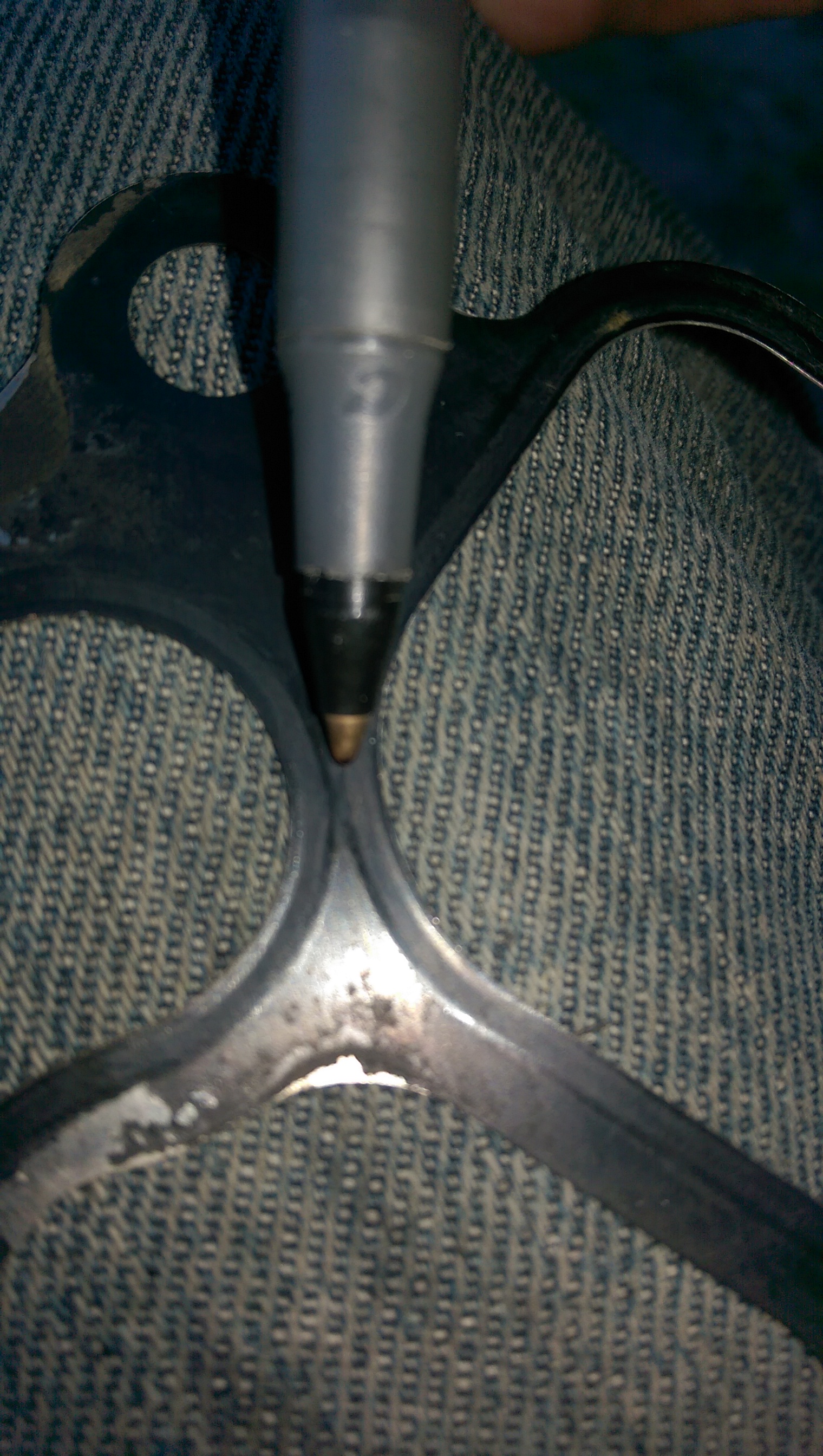

Originally Posted by thisguy357
the only thing coolant coming out of the over flow means is that compressed air is entering the cooling system from somewhere...
agreed.....
so if the compressed air is not coming from the combustion chamber, then tell me another way compressed air can enter the cooling system
Old Dec 4, 2015
thisguy357's Avatar
Joined: Nov 2015
Posts: 45
thisguy357 has a spectacular aura aboutthisguy357 has a spectacular aura about
Re: 2001 Head gasket Again?????
Read MY second post
Attachment below shows how close the egr and coolant ports are together

Old Dec 4, 2015
thisguy357's Avatar
Joined: Nov 2015
Posts: 45
PmI read my first post...after sitting all night I could start the car for a few seconds.NOT long enough to expand liquid..then turn off car and the radiator already had pressure...for the second part of that yes the coolant is SPRAYED all over my plastic intake plenum...oh and my head was within .0015" (father in law is a machinist and he was astonished because my car was "overheating" for 9 months of Texas summer ) I'm thinkin te exhaust bubbles at idle, after warm, are what makes the temp rise because u have hot exhaust gas trapped by your temp sensor...then one u take off the coolant circulates and the sensor cools down..
That's why I think he needs to replace the easy cheap part first

thats why i would like for scout1 to try to change the water passage gasket, im thinking it may blow from increased exhaust manifold pressure. ive seen this issue on another car ive fixed, i just cant for the life of me remember what kind of car it was. but i remember the egr was mounted to a cooling block just like hondas configuration...kind of like the ford trucks that use to use EGR coolers
they had the same symptoms... no loss in compression, leakdown test is good, possible white smoke(but not generally) and coolant bubbling from radiator(mostly under load)
I'd rather see tests and proof before randomly replacing stuff.
Test, don't guess.
Old Dec 6, 2015
all the test to determine egr gasket failure in this configuration would be inconclusive...u kinda just have to change it ($8)
it wouldn’t leak compression, so a compression test would read within spec, and so would a leakdown test. if u did a block test it would read that there ARE gasses in the coolant but i believe thats from the EGR(like on a ford) this wouldnt effect the drivability at all, except coolant loss and overheating
Pressurizing each cylinder to 150-175 PSI should prove or disprove a combustion chamber breach (head gasket).
The results of that test would dictate the next step.
yes i agree, but thats already been mentioned. what im saying is that if a compression and leakdown test test good, i bet the thermostat housing/Waterpassage/egr cooler gasket failed
