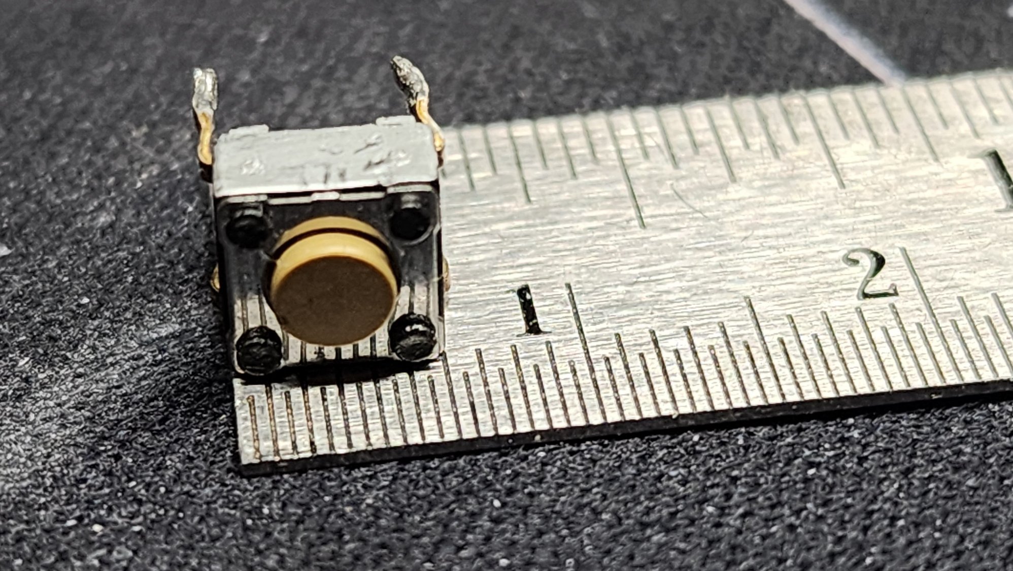

so, I've changed out the switch for an EM2 odometer reset/maintenance reset button before. It's just a regular *** little momentary switch. I couldn't tell you actual measurements, because I found a switch that worked that I harvested from taking apart an old TV (because it was broken and I wanted to break it down to see the insides. lol). It's honestly not that hard as long as you have basic soldering skills.

Edit: I dug through my container of electrical components and found a switch that is identical to the one I swapped in. It's a 6mm x 6mm normally open tactile switch.

Can't make any guarantees, but this might work. If it doesn't, you're only out $6
