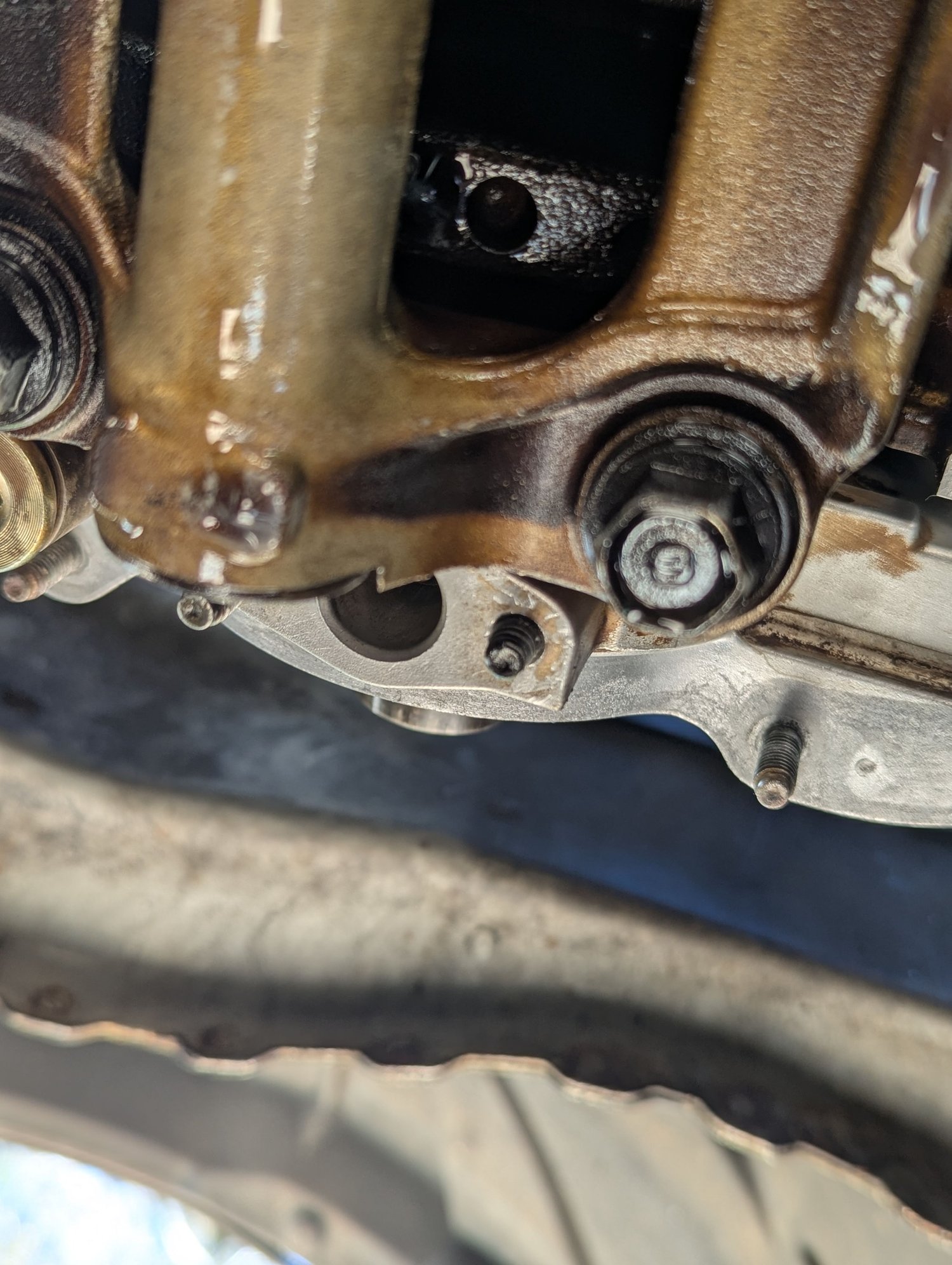

I am in a bit of a pickle. I have a broken stud on my oil pump where the oil pick up tube connects. There is still about 1/4" of stud exposed, so I had the idea of JB welding a nut to it and trying to remove it that way. I would really prefer not to remove the oil pump again. If that sounds like a bad idea, or of anyone has a better one, I'm all ears.
Assuming I can remove it, would a replacement stud be the same as one for the oil pan? They are both M6 and look similar, but if I need to order some kind of special stud that would be good to know. Thanks!
Any advice is appreciated.

I don't know if jb weld will hold well enough. Make sure you get it really clean. I would use an actual welder personally.

Unfortunately I don't have access to one, so I figure the JB weld thing is worth a shot. I'll give it the full 24 to cure before trying. Do you know if a replacement stud would be the same as one for the oil pan? Thanks

just go to an online parts store and find both studs (they have diagrams, easier to find).
If part number are same, they are same.
This is the closest to me, you can choose a closer one for yourself.
https://honda.oempartsonline.com/
