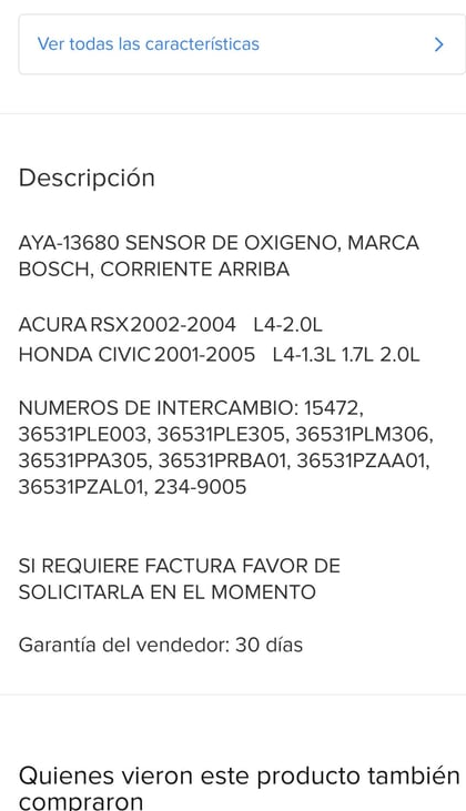

One problem I see with that listing are the OEM part numbers listed.
The first and 3rd part numbers are for the 01-03 VTEC downstream sensors (bank 2) for the D17A2 (VTEC), and are of the narrowband variety. The 2nd part number is the upstream sensor for the 01-05 Civic GX (natural gas). That said, that sensor is highly likely sending wrong signals to the ECU, causing a terrible AFR/fuel trim.
You should be searching for the part number 36531-PLM-306
Thanks, if my fuel economy doesnt improve i will buy that one, but first i am going to fix the wiring that doesnt even reconogsise any sensor at all
curious to see that they sell these parts wrongly, how did you knew the exact serial number of the part that i am searching for?

the electrician has seen the car and told me that the wiring on the sensor was weird, the ones that i bought as you guys said previously in this post seems to be for different cars, i have asked my dealership for a replacement part but they said that they no longer have those because they are outdated.
i have searched in the internet in various places but all i can find are generic parts that they they are compatible but i am not really sure, the one amazon post that sold the OEM part is no longer avalaible and sites like hondaautomotiveparts dont ship to mexico
Are there any suggestions on to where i can get a good replacement?, the junkyard have a few civics but most of them are 4 doors but i will start asking there first.

I have searched for hours for a compatible sensors, as a person said up in this thread, i need a wideband air fuel ratio sensor, i searched for the OEM part but is simply too expensive and some pages simply dont ship it to mexico
I have seen some alternatives at a reasonable price
The OEM codes were
36532pnda11
36531 PLE 003
And this one that has not a number in particular
