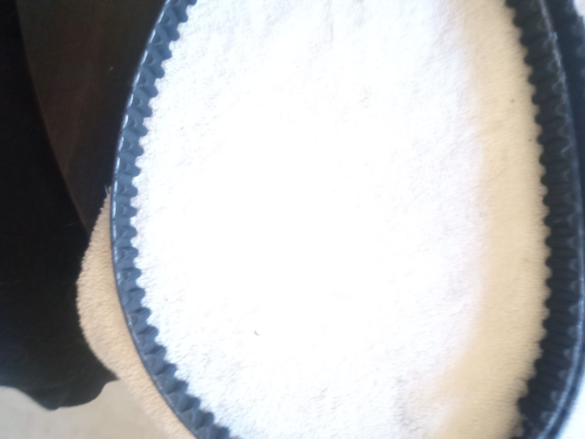

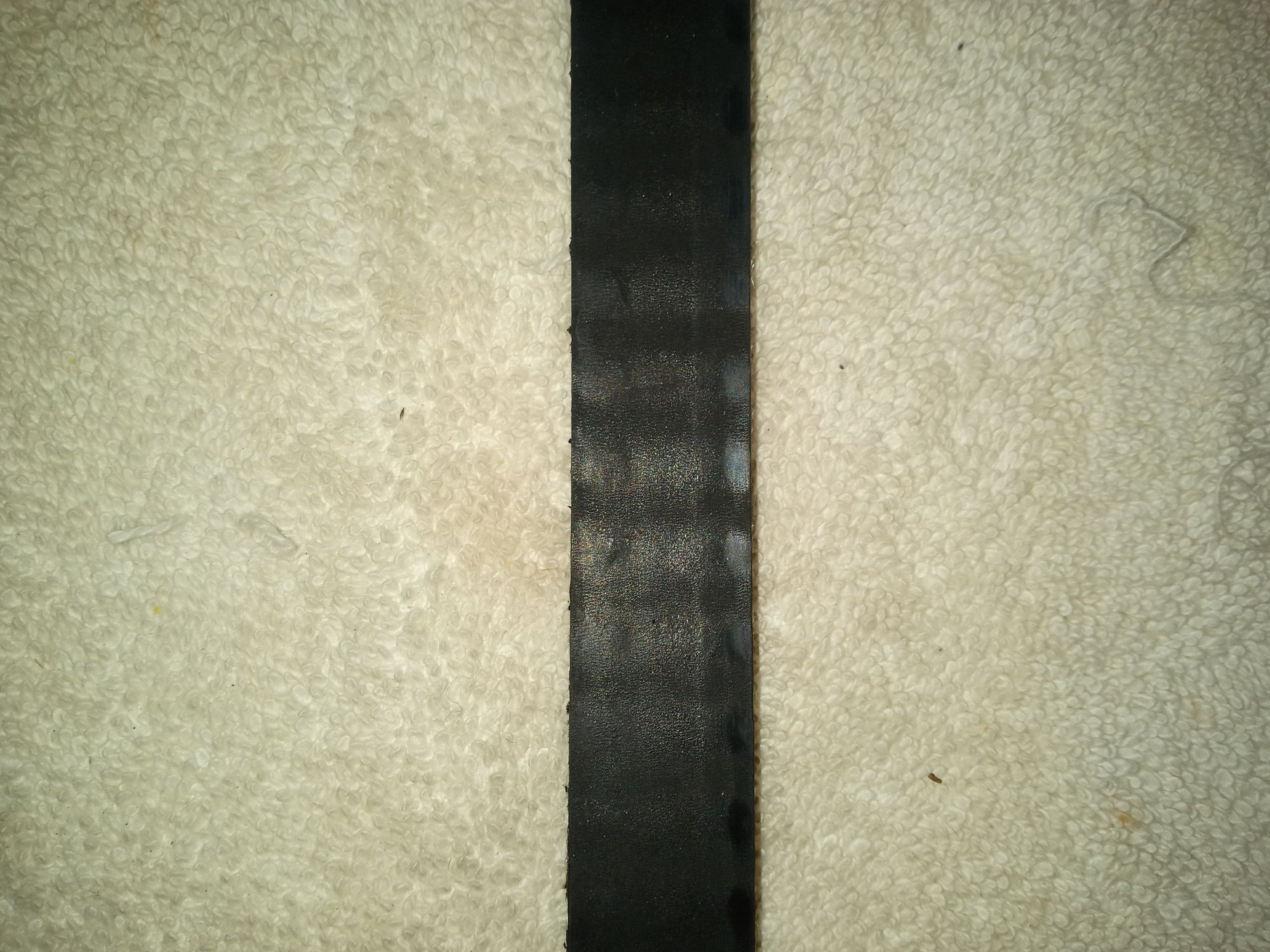

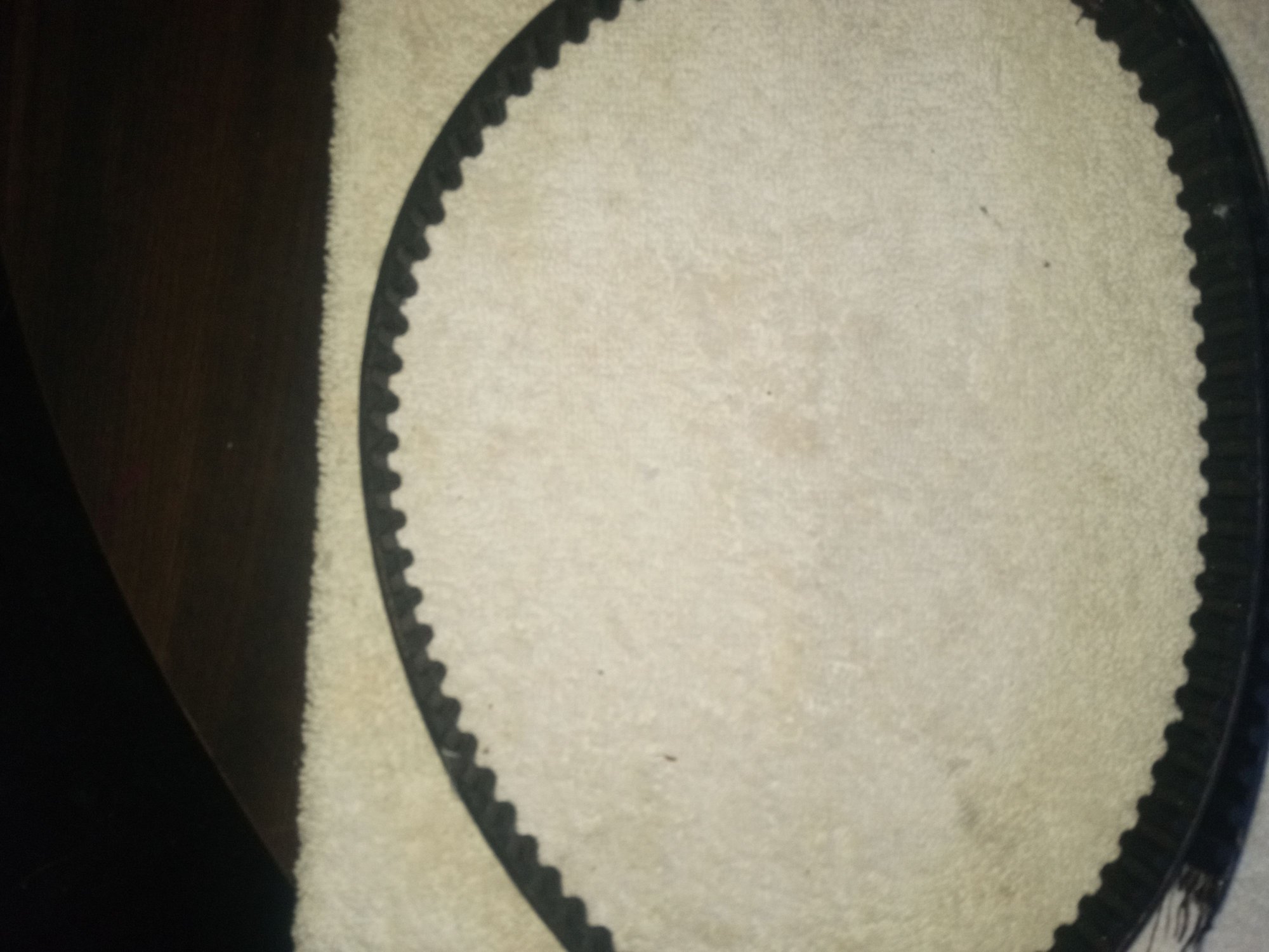

Hey guys more fun news on my 05 timing belt. It lasted about 4,000 miles! I had left my upper cover off of it, so I could keep an eye on how it was doing. It seemed fine for awhile, but then recently it was pretty loose, on the front side of the belt, but tight on the rear side. I left it go, and it snapped on me driving last Friday night. I thought it had just slipped, but no it was snapped. I have it all apart now, but stiil don't know about the damage? I need to mention that I couldn't find anything loose with this broken belt situation now. The problem is once again my lower cover was really packed full of shavings. I think something caused a weak spot and it snapped. I will send a photo with a good shot of how it broke. The belt teeth all look good to me. The first belt looked ok too, In that case it was obvious the tensioner had came very loose as the tensioner bolt had all but fallen out. Only the cover kept it from falling out on that first fail and jumped timing off one tooth. I had helicoiled that stripped thread situation. On my original problem the belt had cut into the lower cover really bad, and I got new covers. I didnt clean my lower cover yet so I'll send a photo of how bad that is packed with debris! Some shiny particles in the debris too. I'm trying hard to get this issue resolved, and fix it right this time. I know the belt was running loose on that front side quite awhile now. Maybe that caused the debris, and for it to wear and eventually snap? I'll get those pics to you guys today. Please advise me, and thank you.

It is a " Evergreen " brand. It definitely has rub marks on it when I just found it and looked closer. I struggled with the first timing belt replacement due to that stripped tensioner thread. The tensioner bolt was still nice and tight this time though. You guys need to explain what the heck the belt could be rubbing on? The alignment looked fine to me. All was good after a few rotations. Then I torqued it to 33 and pulled the pin out. It ran fine but I feel certain I heard what I thought was a rubbing sound?

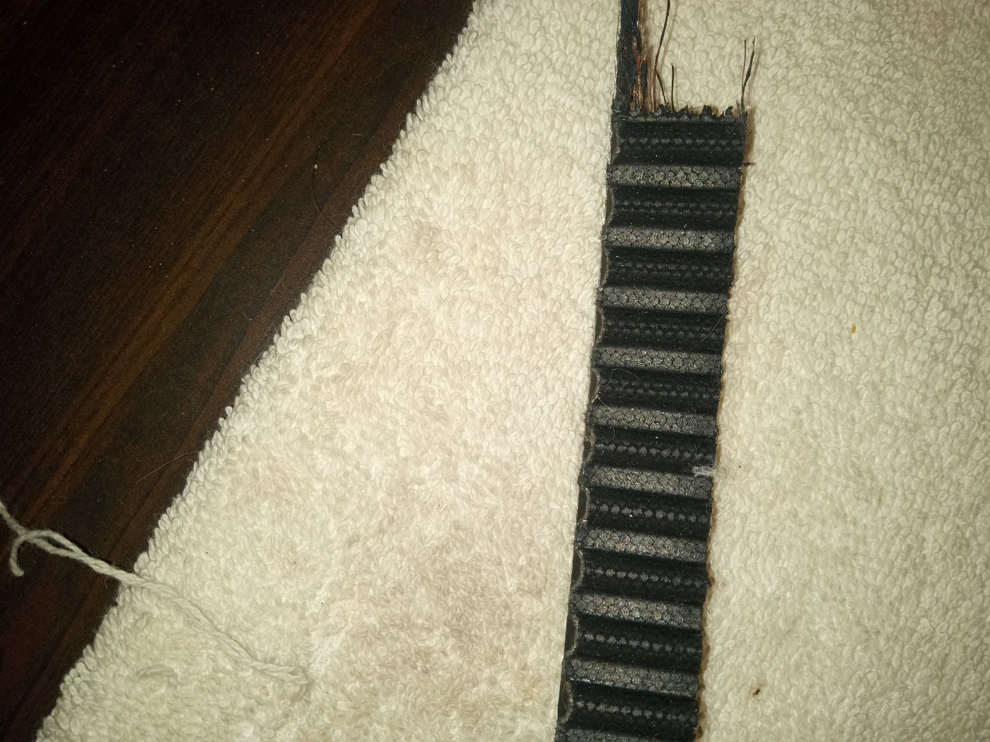

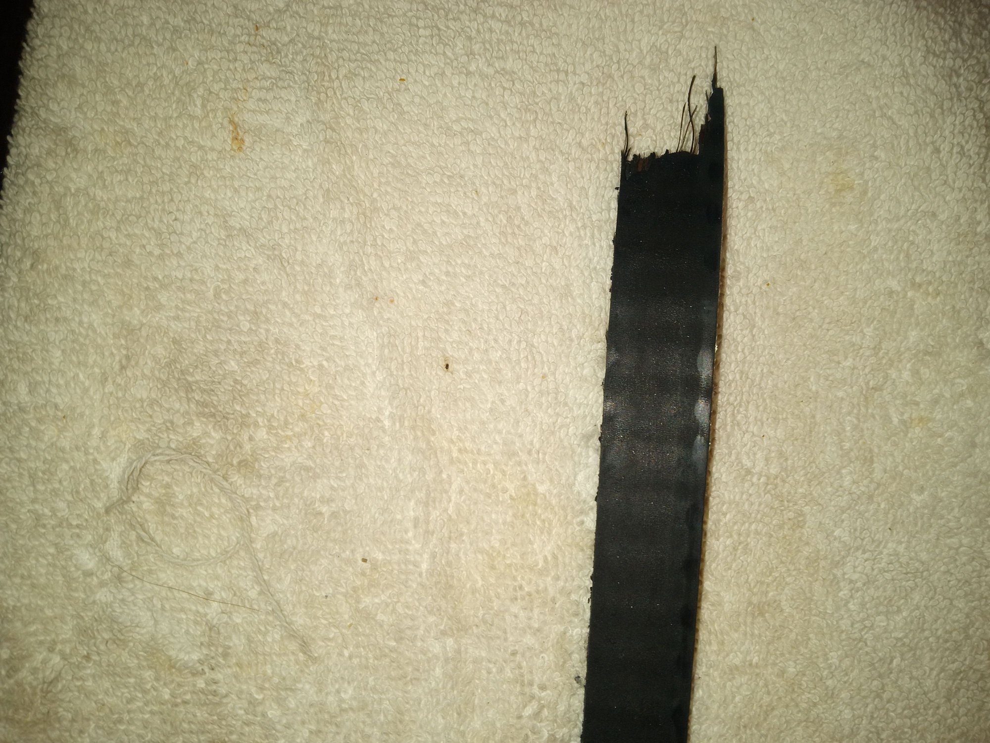

More photos

re: More timing Belt problems on my 05 LX [solved]
Cheap kit is probably the issue, we recommend oem or at least gates
